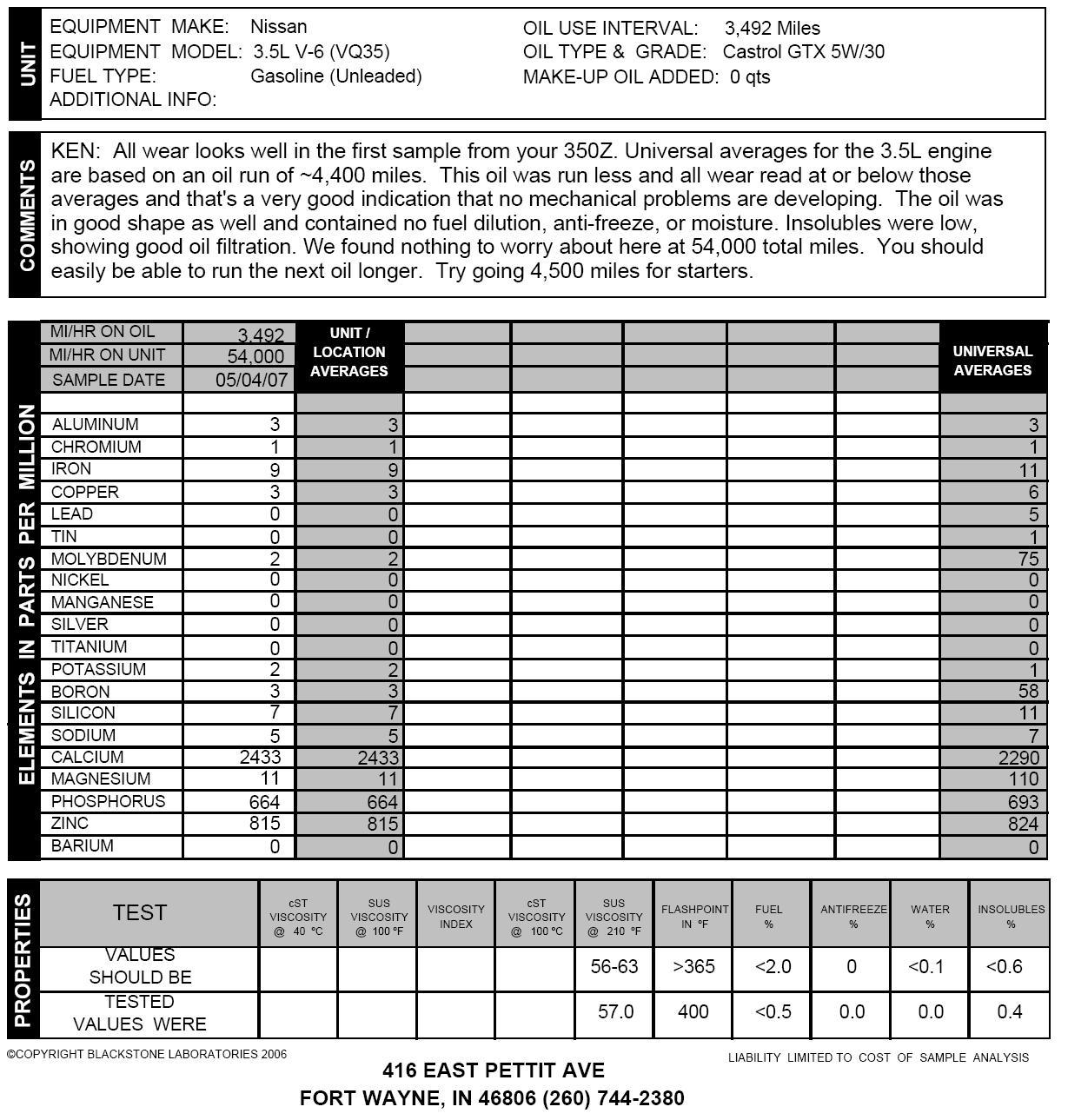

I have been using Castrol GTX 5W-30 dino oil with a Pure One filter. From the oil analysis thread Castrol has been the best non-synthetic oil for the VQ. So I have been sticking with that.
