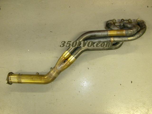

Didn't Xerd or somebody with a name like that make long time headers a long time ago?
Old Apr 6, 2007 | 01:00 PM
  #329
MIAPLAYA's Avatar
MIAPLAYA
Posts: 11,373
From: Escondido
Hmm then theres only Crawford and 350EVO but I don't know if either of them is in business either. Heres a pic of the 350Evo headers from long ago...
