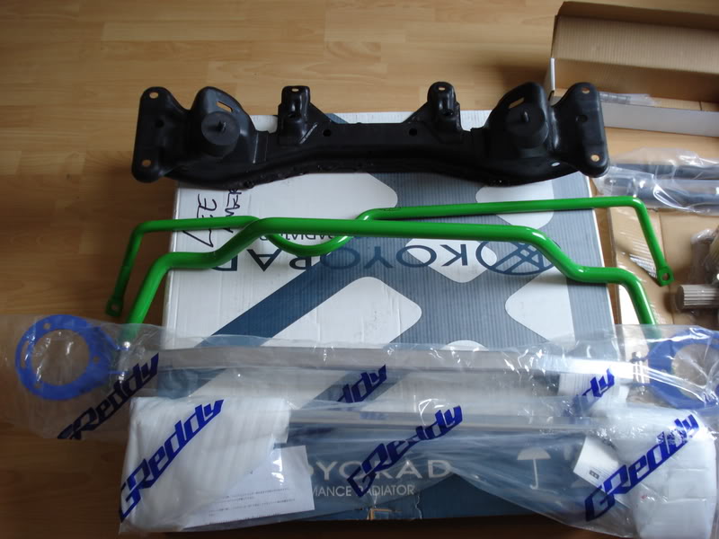

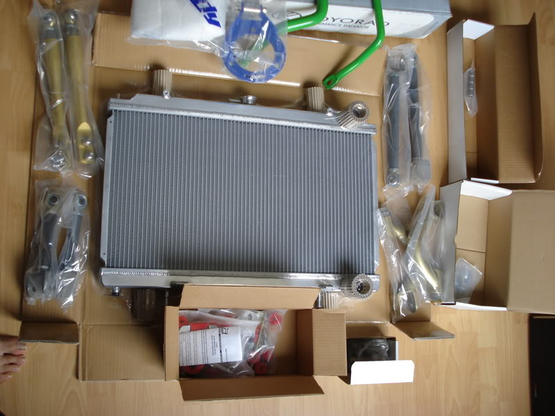

A genuine s14 x-member made to work with the vq came in today! Had a snowstorm up here so I wasn't all that motivated to go and work on it in an unheated area.
Also went to Calgary to pick up all my suspension parts and cooling items!
Will get the x-member in tomorrow and hopefully the engine and tranny as well!

Peak Performance suspension and koyo rad

X-member, Suspension Techniques sway bars, Greddy tower braces

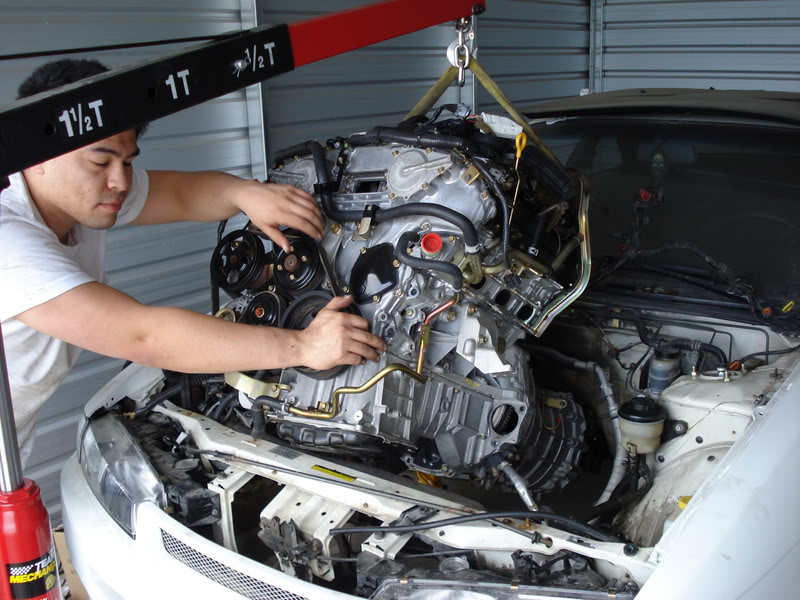

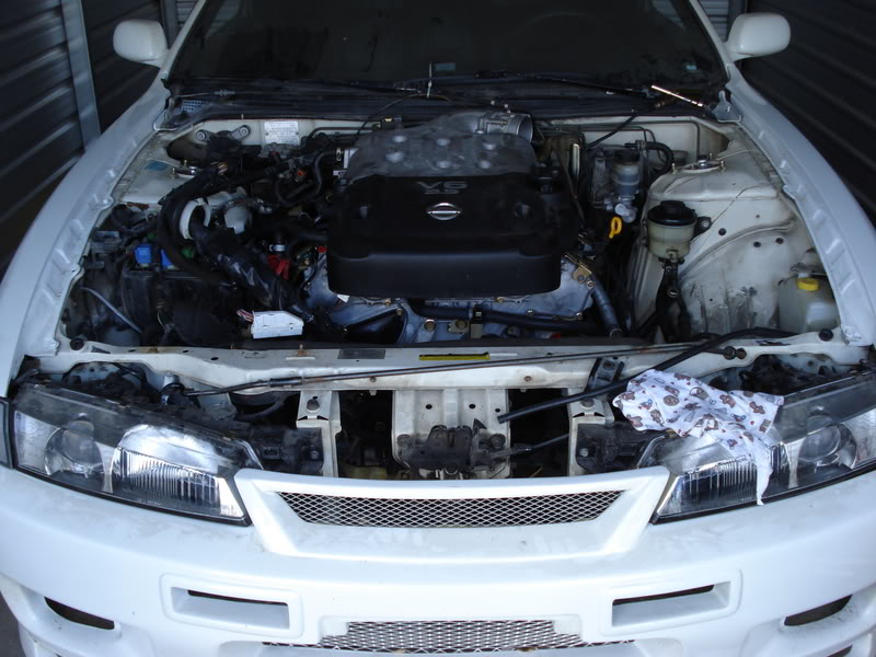

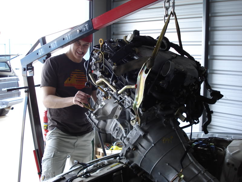

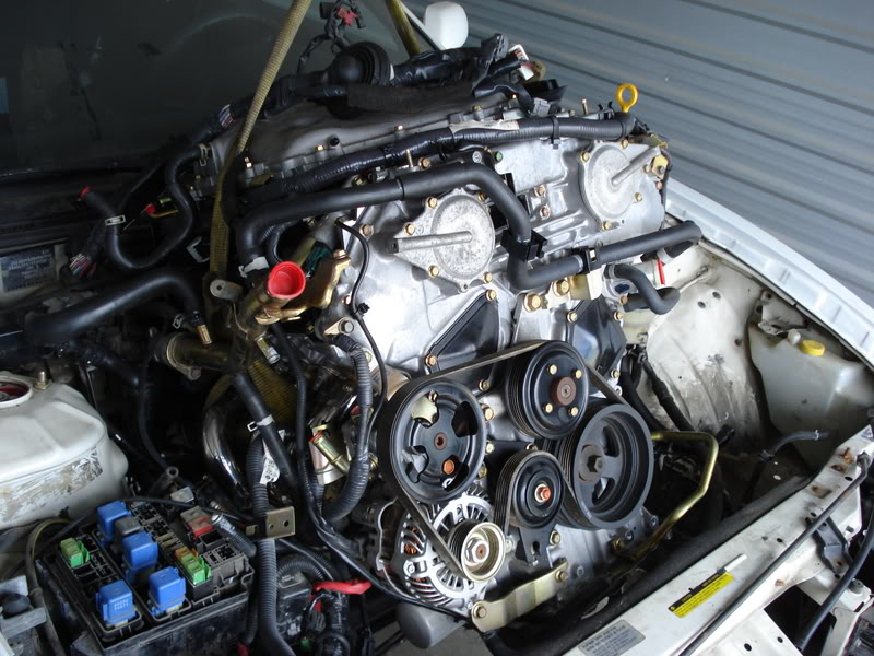

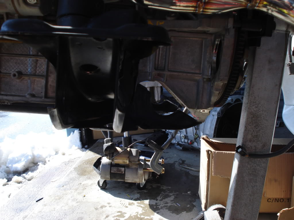

Old May 6, 2008 | 03:33 PM
nismo240r's Avatar
nismo240r
Joined: Dec 2007
Posts: 165
From: Edmonton, Alberta, Canada

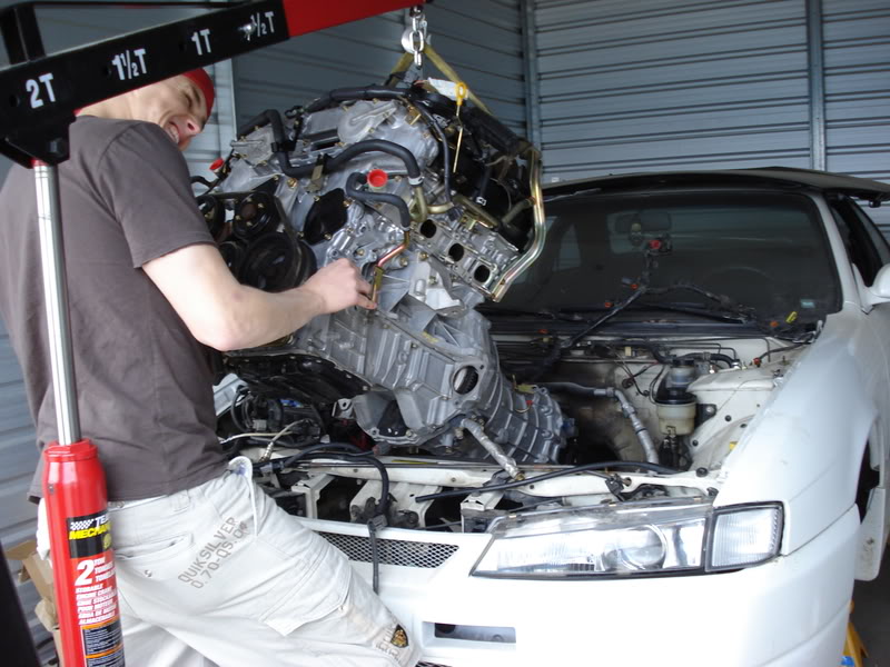

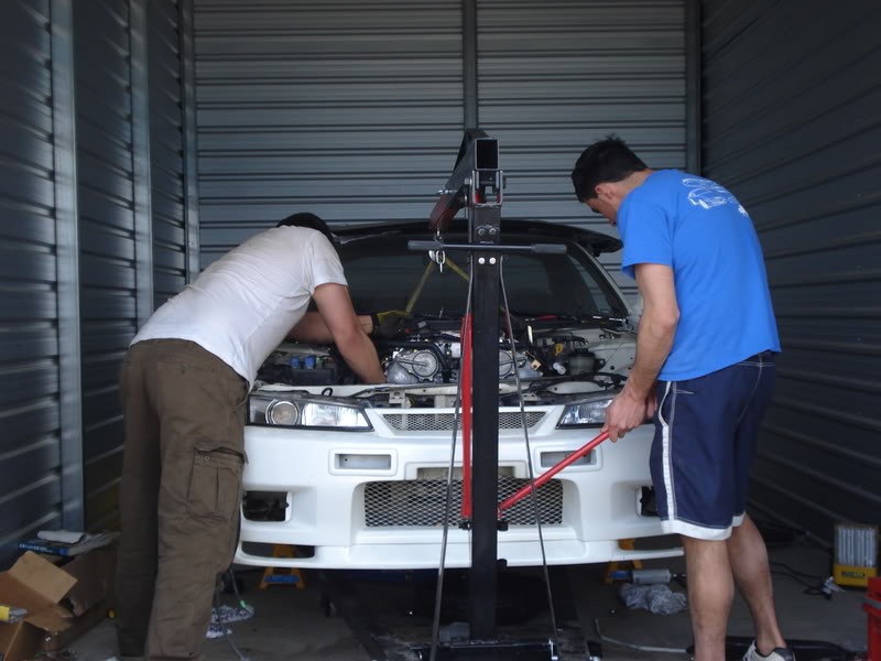

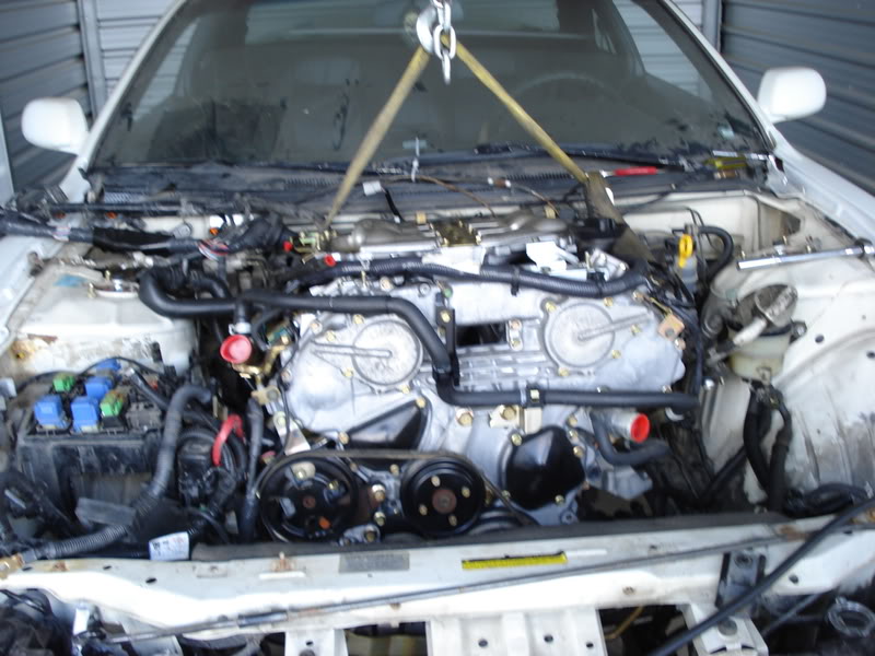

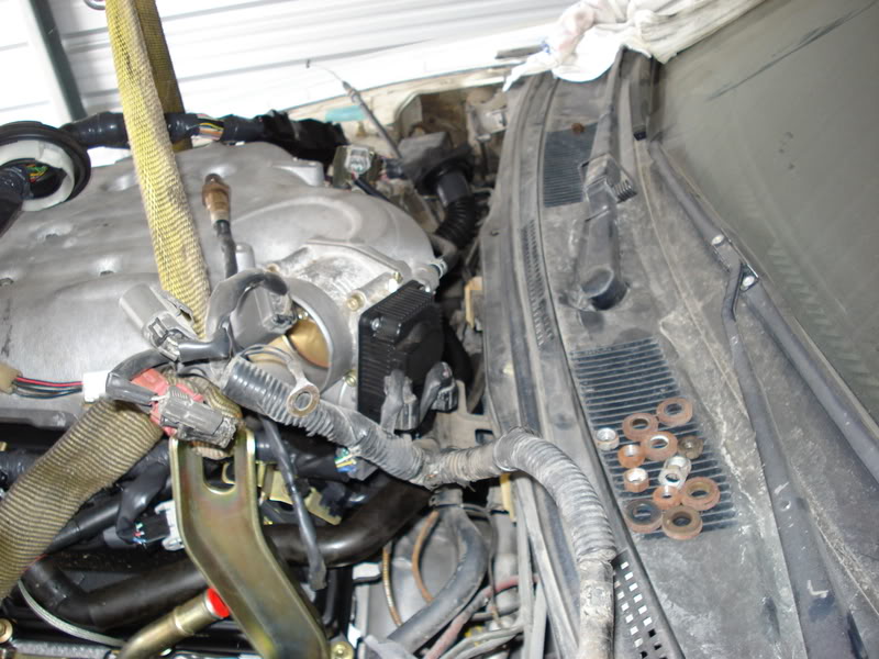

Engine and the transmission are in, this was just to mock it up to check clearances. I had to remove the left header as one of the pipes was interfering with the steering rack knuckle. Looks like i'm going to have some custom ones made up pretty soon here. . .
Engine and tranny ready to go:

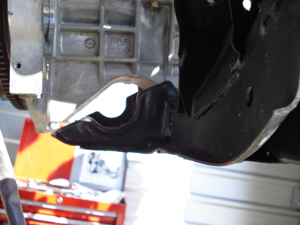

Tranny in the tunnel. . .
Everything is so tight, width and height, would have like to drop the chassis onto the engine and tranny. . . mebbe next time. . .

Tranny peeking into the tunnel. . .
Almost in. . .

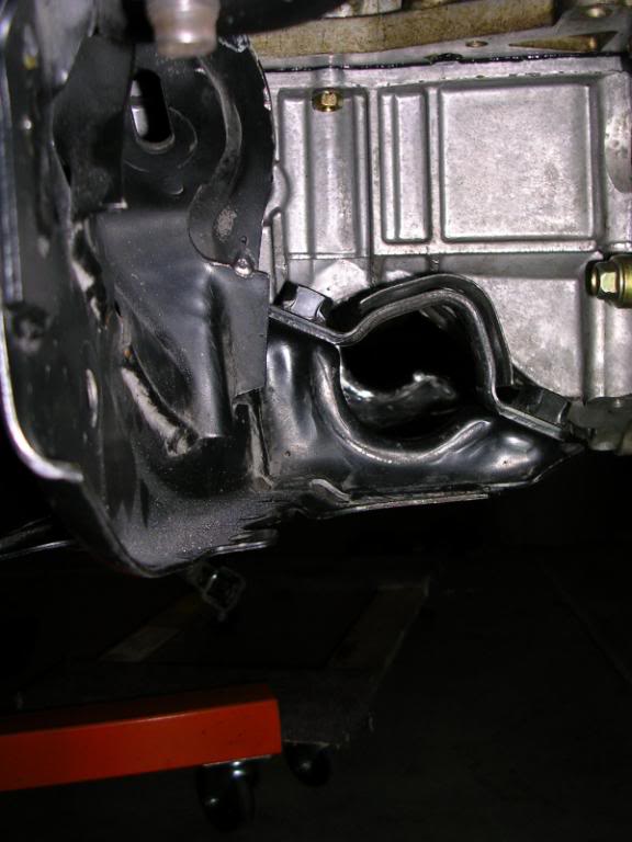

This is about an inch above the mounts. . .
Next time I'll know to remove the plenum as the neck at the top hits the top of the firewall and prevents you from getting any angle. . .

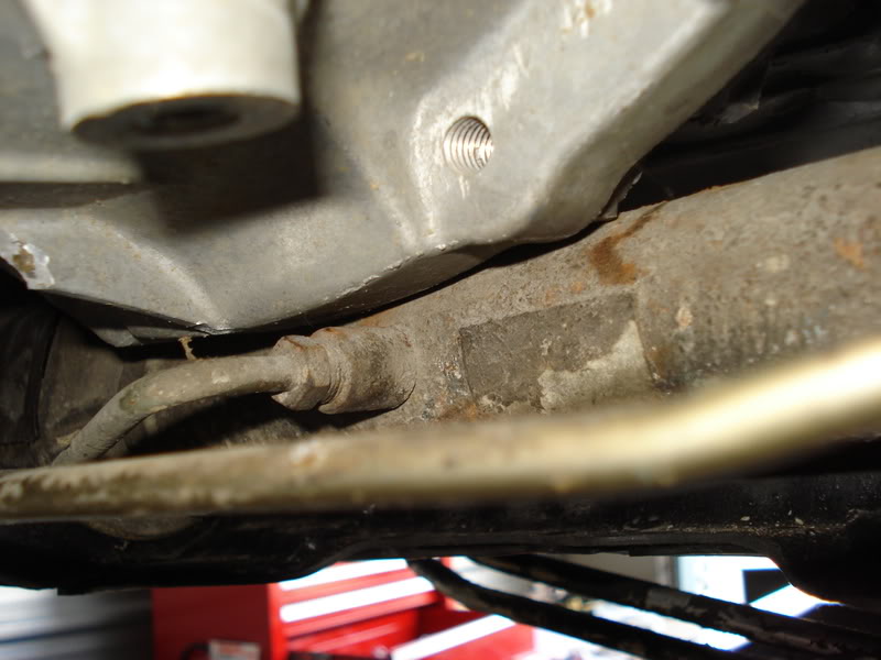

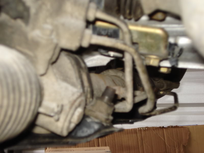

Have to remove the power steering lines from the rack as they're right in the way. . .

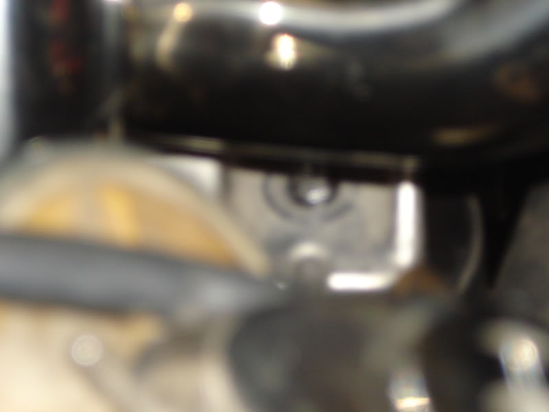

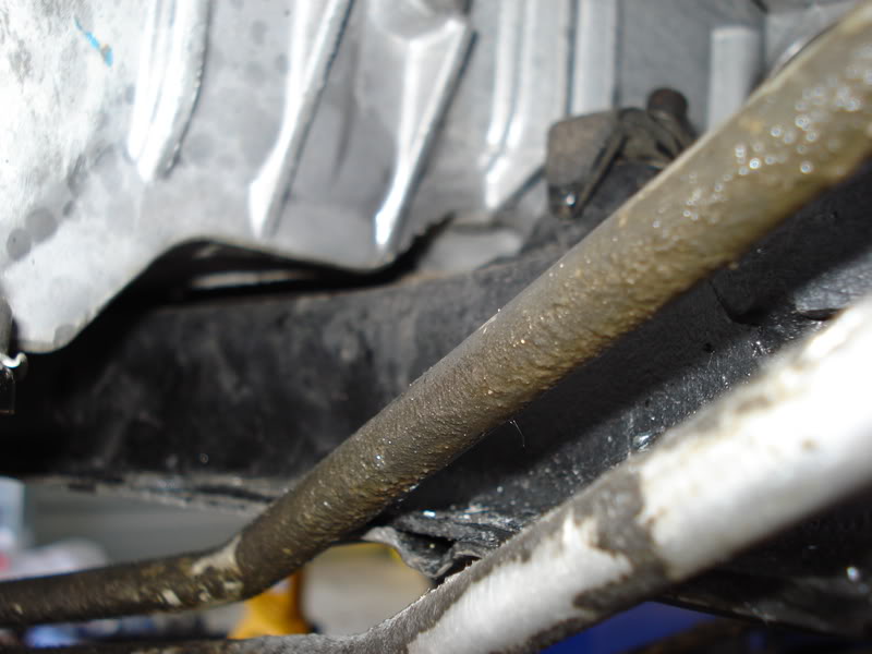

The sway bar will have to be lowered with some spaces as the oil pan drops right onto it in the factory location
IN!!!

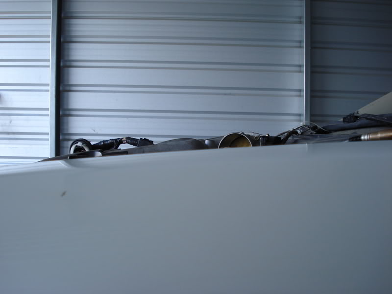

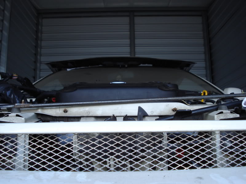

Clears the hood as well!

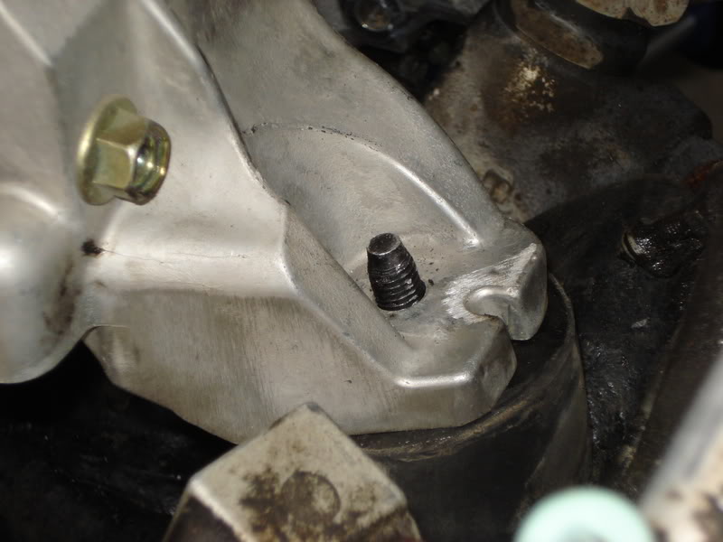

Left mount. . .
Right mount. . .

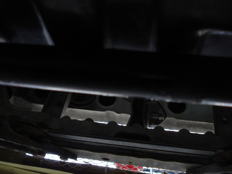

Space between the bottom of the engine and the x-member. . .

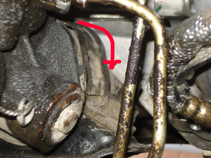

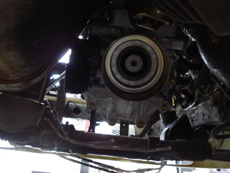

Will have to grind out a little of the ribbing on the engine close to where it meets the transmission as it's just rubbing on the steering rack. . .

Hoodline. . .
