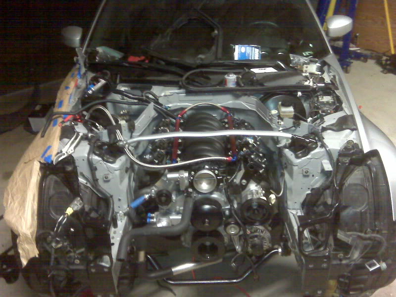

Also if you notice at the bottom of the picture I was able to incorporate the VQ torque damper with this engine(lower left of the screen)..hopefully this will keep movement to a minimum and wont rip in half with this engine haha

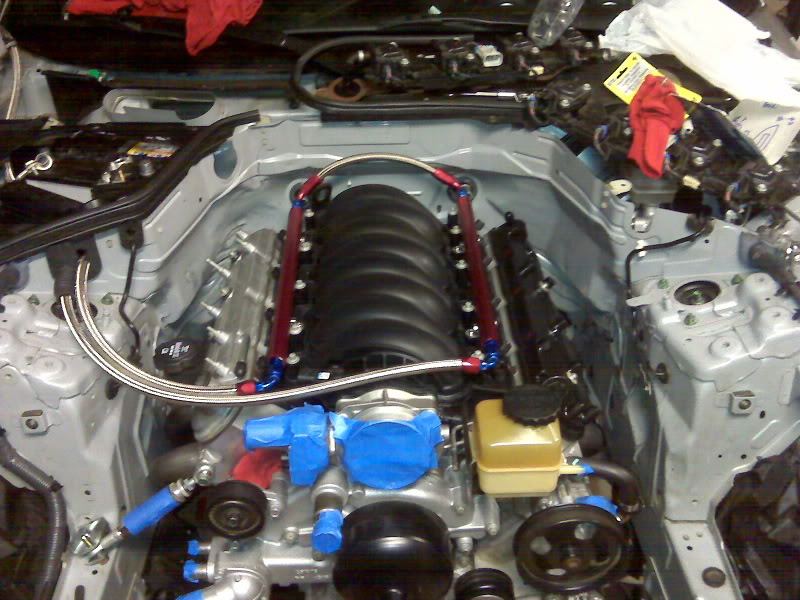

its much beefier in person..pics dont do justice. also got my fpr and all my fuel fittings so I can finish up the fuel..just waiting on my fuel return bypass.

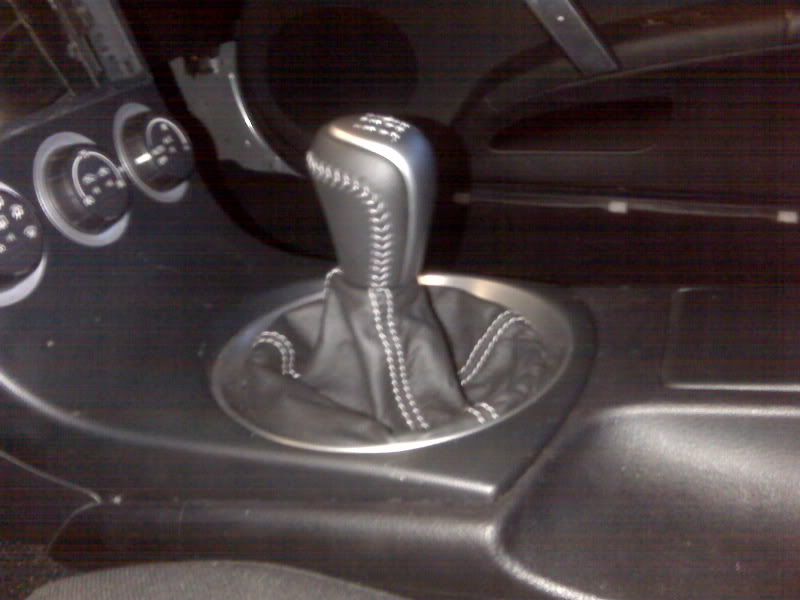

Got a little creative today..took the OEM GTO boot and cut and made it fit to the Nissan center console..

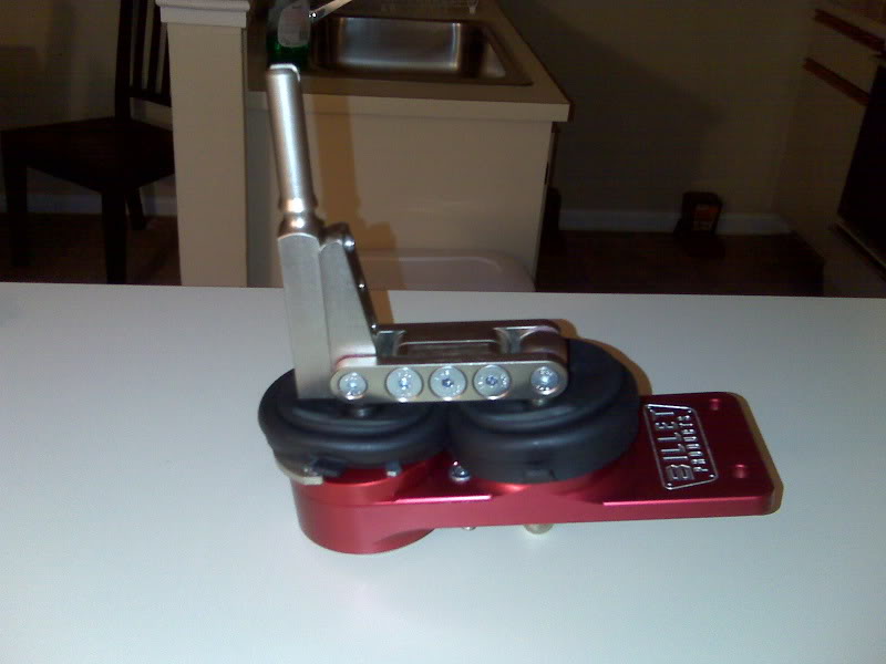

So close..few more days...
