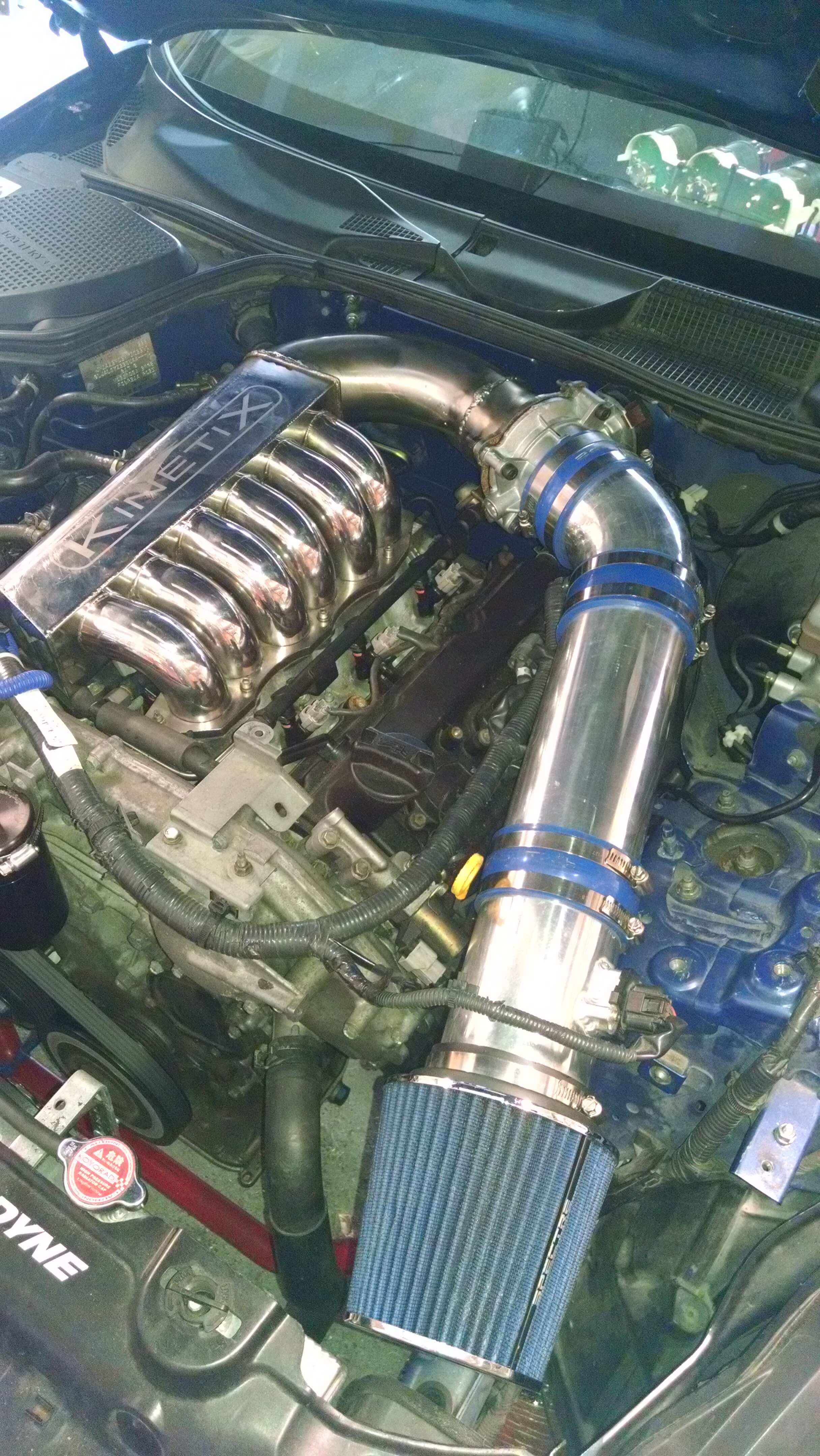

Got it pretty much done. 3.5" elbow welded onto the end of the plenum. Made my own TB adapter and re-used the 87mm TB. Still going to use the 4" intake piping and MAF. I am still trying to figure out where how I am going to route the filter outside of the engine bay. This thing should flow a lot more on the top end and free up some power. Have a new clutch to install and redoing pcv stuff then will get it back on the dyno. Probably in June sometime.
