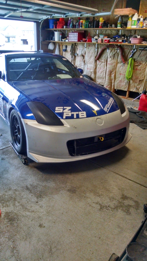

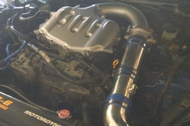

Spent everyday after work this week putting the rest of the car back together and getting things ready for the first event. Dyno shop is booked solid unfortunately. It's looking like I will have to take a day off work or half day to be able to fit into his schedule during the week. Shooting for some time this coming week. Taking the car to my buddies house today to do alignment and see how much this thing weighs. I am hoping around 2850 without me in it. It has between 1/2 and 3/4 tank of fuel right now so it may be on the heavier side.
Finally got the hood bracing cut out that was needed so the hood would shut with the new intake. Here are some pics.
