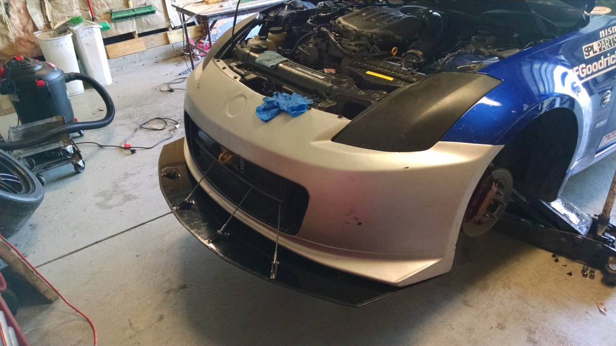

Never made it to the drag strip. Ran into other issues, but that's another story. This car is consuming my life!!! So I spent much of the day yesterday and today so far working on it. Holding out hopes I can still make the Mid Ohio event next weekend. I spent a lot of time making a new splitter out of Alumalite. It is almost done.
Oh...and I am pretty sure I found my issue that was causing my problems on the dyno. I found the crank position sensor was loose. Man am I embarrassed. It wasn't super loose but enough I could wiggle it with my hand. The bolt was tight, but sensor loose. I grabbed the wrong size bolt and the one that was in there was too long and bottomed out before the sensor was tight. I removed that bolt and put one in there that actually tightened the sensor. I am sure that thing was vibrating and moving around a lot at high RPM (especially with solid motor mounts) and that might be what freaked the ECU out. I am about 90% sure that was my issue. As precaution though, I replaced the IVT solenoids and cam sensors. Trying to schedule dyno this week so I can make first event Saturday/Sunday next weekend. If he can fit me in, I can finally get this thing tuned and get it out on track.
Here is pic of splitter in the works. Working on air dam now to seal around front of bumper. Do you even downforce bro?

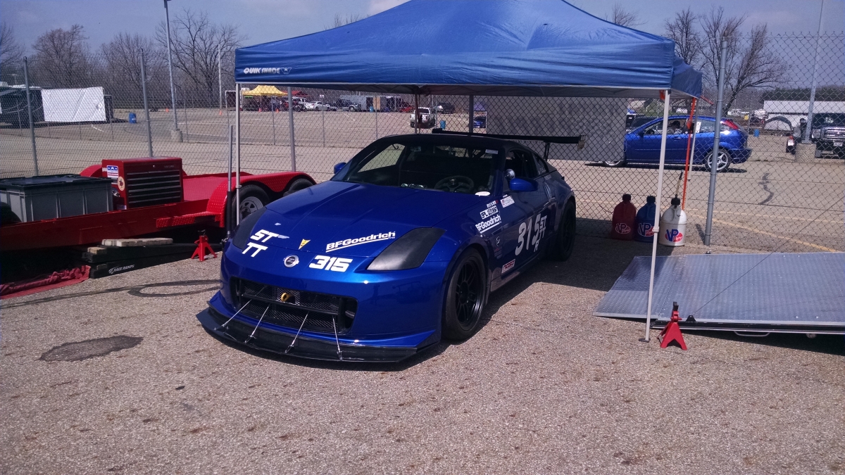

Car and motor held together for first track weekend. Better news... I fixed the cam timing dumping to zero issue. It ended up being an electrical bug caused by a faulty kill switch. Once I bypassed the alternator posts on the kill switch all my dash light flickering went away which was also an issue. I did some data logging on track Sunday morning and confirmed everything is working as it should now. So glad that is fixed, but sucks I wasted two visits to the dyno.
Now to get the fuel issue fixed and get this thing back on the dyno for hopefully the last time.
Here is a pic of the car in the paddock. I love the way the new bumper turned out.
