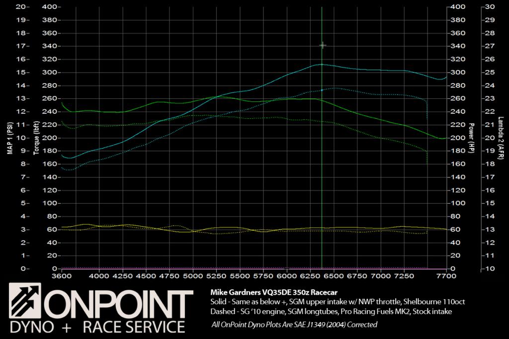

At 4800 rpm it looks like my engine made about 232 hp.
Old Apr 2, 2015 | 06:20 AM
  #369
2TH PWR's Avatar
2TH PWR
iTrader: (21)
Posts: 8,159
Likes: 107
From: London, Ontario, Canada
My last dyno. currently undergoing rebuild. new injectors. new exhaust.

Nice!
I am not far off that at all. We will see what happens once I get this sorted out.

That TQ curve...I mean straight power line. That's just awesome.
