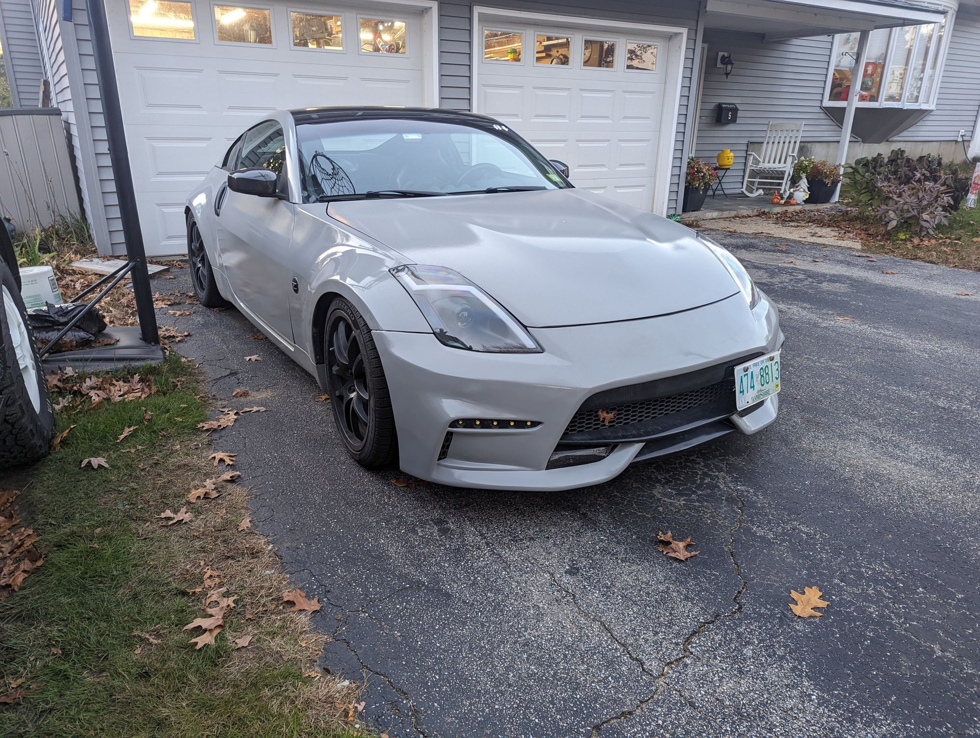

Well, dropped the car off in July go get the gallery gaskets done as I had a coolant weep coming from the water pump and figured I had pushed my luck far enough with those. Replaced the radiator with a nice aluminum CSF one along with the thermostat but the tiny leak persisted so I figured it had to be the water pump.
Poor car was gone until about a week ago, not really happy with the timeframe nor the $4k cost but she's got a nice laundry list of new parts now and I am finally confident I could go play on the track with her and not worry. So I had a new Z Speed stage 3 street w/Billet Steel flywheel sitting around for a potential supercharger and since the mechanic was doing the rear main seal (almost without telling me) I had him put that in too. She's got a new serpentine belt, gallery gaskets, timing chain, cam chains, all guides, tensioners, water pump, a Stillen lightweight crankshaft pully, and an oil pan spacer with an oil pan. A lot of stuff that just made it easier to button her back up with new parts, a while you are there pile of stuff! Annoyingly they forgot to bolt the exhaust back up after the mid pipes, missed a ground connection, and routed the front wiring harness in the wrong spot so I had to take it all back in order to mount my under shroud. Unbolted my ground connection and the AC discharge pipe blew off the condenser and scared the **** out of me, ordered a replacement from Z1 for a coupe hundred bucks, ouch.
With this being gone for so long it gave me opportunity to fix the giant flaked off paint spot on the front bumper and finally decided what to do with the rear wheel well rust. Ordered some Nismo rear fender flares from Nengun in Japan so I plan on cutting out the rust and mounting these, much better than my original idea of the full quarter panels. A little nervous about just hacking off around the rear wheel wells but in the and the rust has gotten behind the rolled lip and I don't think I have much of a choice.
Either way I am just super happy to have her back on the road again. Good timing because my Cayenne decided to start misfiring at the end of last week too so one project down and another pops up!

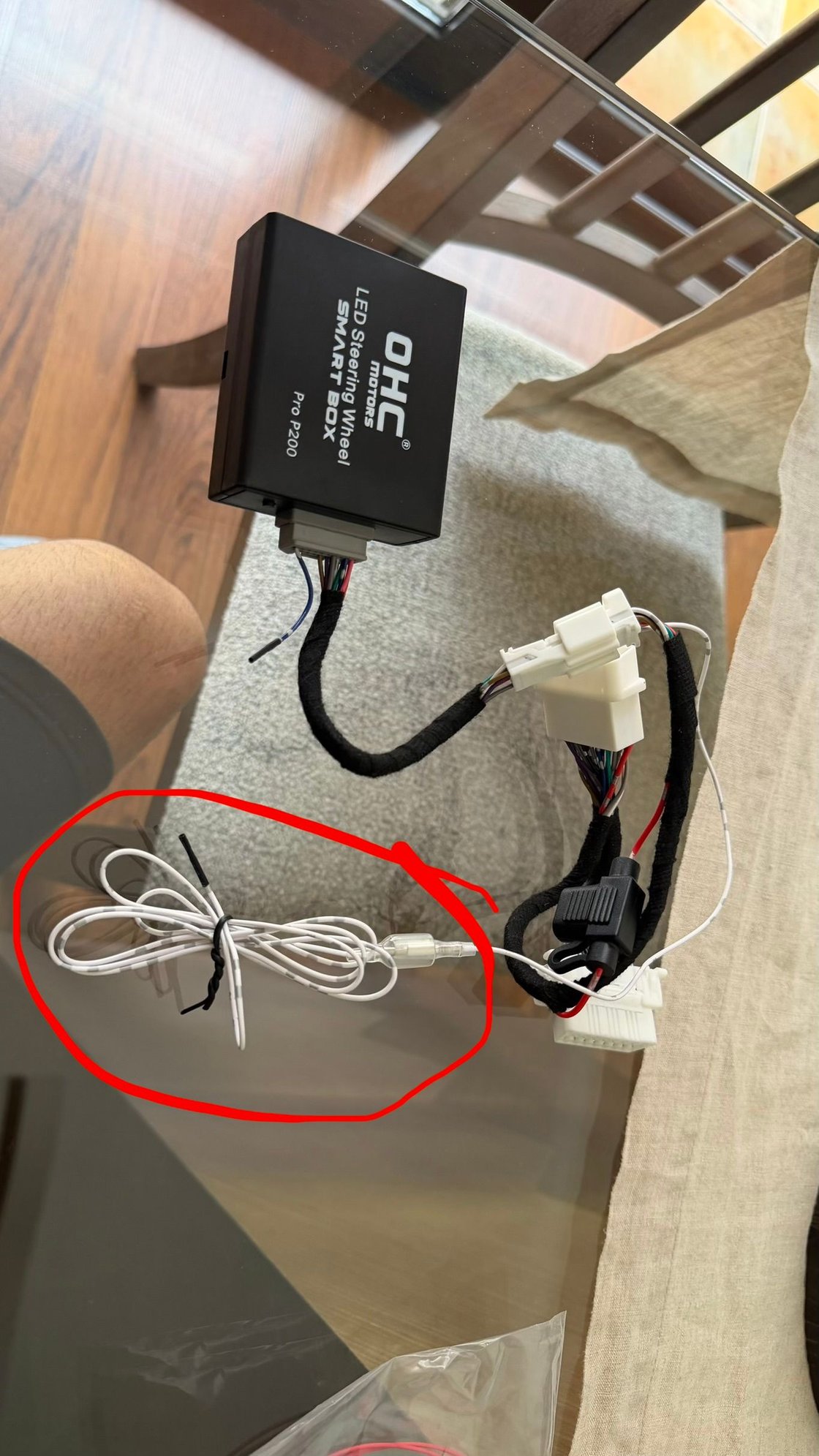

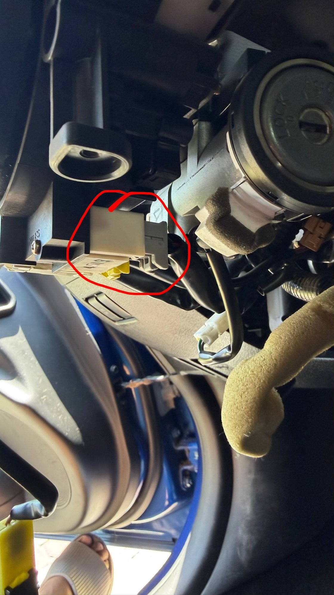

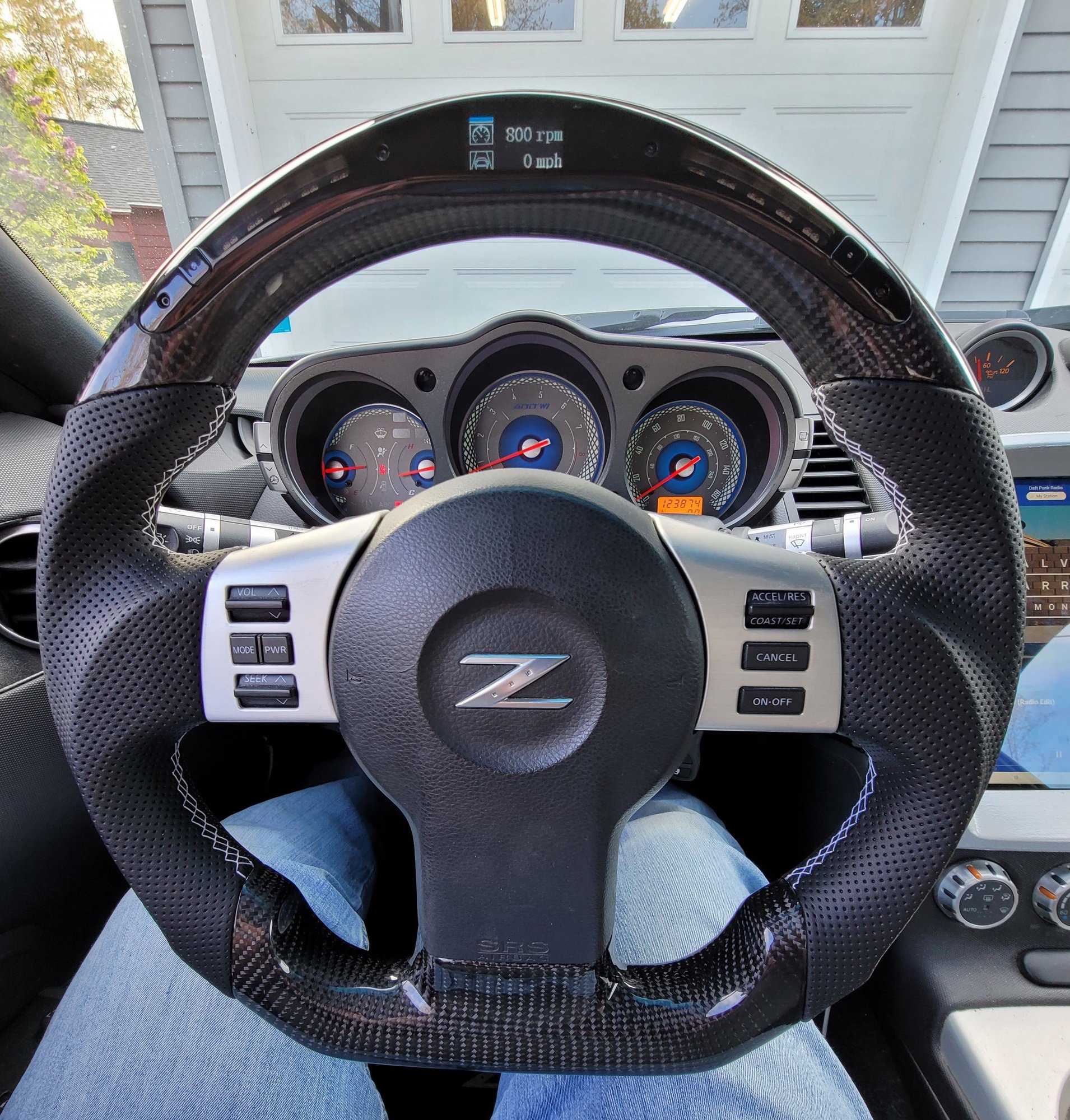

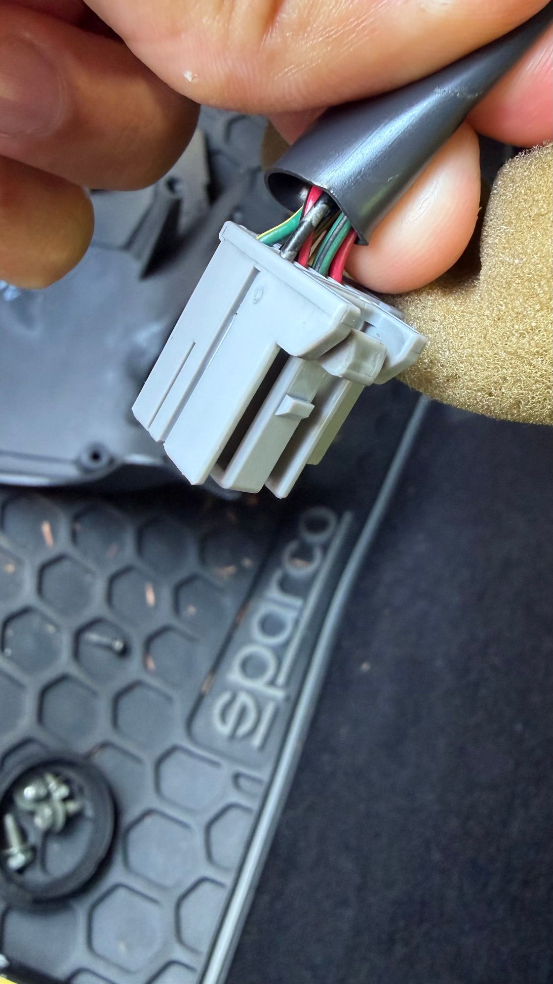

Originally Posted by Randallflagg
Ok, more fun stuff. So I was thinking about a way to update my steering wheel while retaining the airbag for safety and inspection purposes (NH can be brutal). I found the Vicrez steering wheels (OHC Motors) and just couldn't resist with a 15% off coupon. So I did that and finally installed my MEH gauges at the same time. I had a few issues with powering the wheel and finally found it was a poor ground. Now it is stable and doesn't power down during acceleration or sharp cornering. Not sure how useful it is going to be but it is pretty fun to look at for now. Shift point can be changed for whatever RPM range you want, plus brightness with a few other options. At first I was wondering how I would get used to the fact that the wheel is so thick but actually it is very similar in thickness as my F150.
Hi friend, I bought this same steering wheel and the only thing I need to know is which wire I should use to connect the white wire coming from the OBD module that came with the wheel. I understand this white wire provides extra power to the LEDs and the horn. From what little I've been able to find, it comes from the clock spring connector, but I don't know what color it is and I'm also not sure if this is the connector I should pull the cable from.
clock spring connection
Clock spring connector
steering wheel obd module
Here is the white wire that I need to connect to the horn in the clock spring wire to give it a boost power. I got this information from the tutorial
but it doesn't mention which wire the white one needs to be spliced ​​to.
