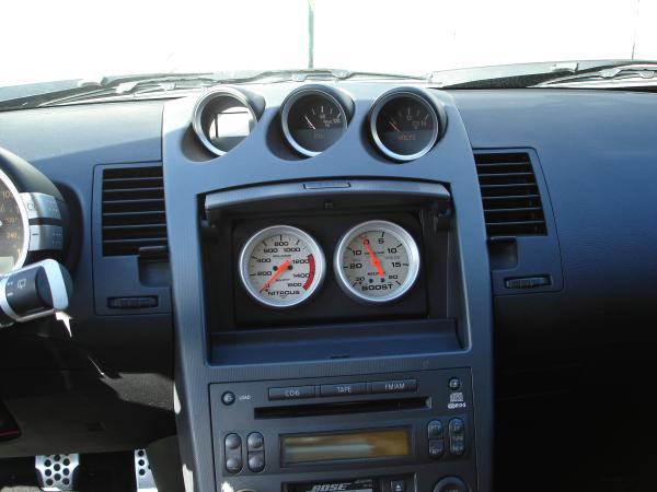

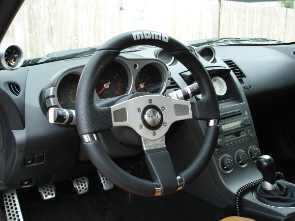

as far as my gauge, i have an autometer electric nitrous gauge that i mounted where the stock navi goes, autometer actually sells a holder for TWO 2 5/8s gauges, they are the bigger ones, it fits in the stock navi place that you dont even have to use anything to hold it if you didnt want to, i just have my nitrous and my vacuum for now, plus the shop didnt have an electric fuel pressure in that size/style, i just needed to put something next to it and i figure vacuum/ boost will remind me of my soon to be turbo kit, here i will attach a picture...

Sweet setup man! Yea my a-pillar has the AF and I was going to put pressure in there. I will hit up autometer this week! thanks!
