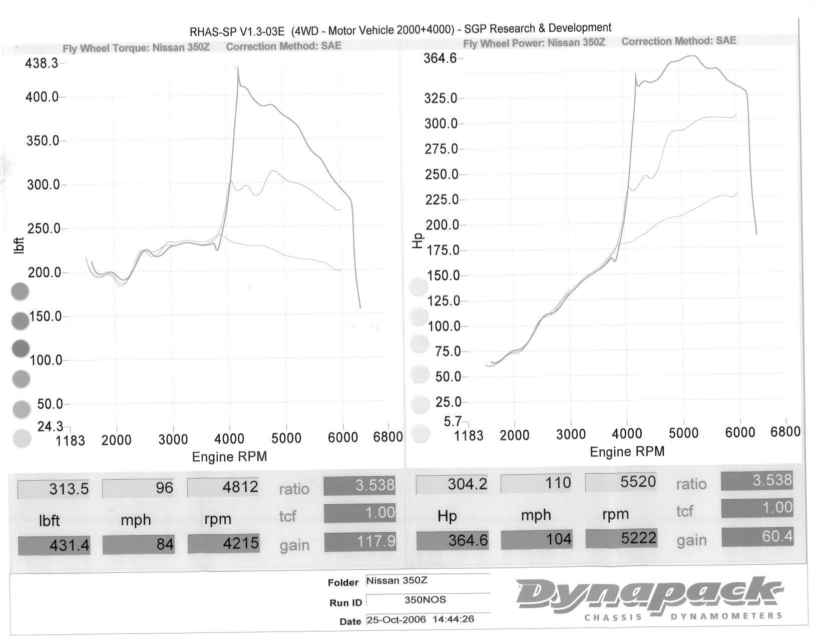

here it is....wish it scanned in color....oh well....all motor, 75 shot, and 150 shot. I'm sure you can tell which is which. Keep in mind this was done on a dynopack....dynojets tend to read a little higher. The run that the clutch let go is shown by the top figure on each side (torque/hp) of the chart - b/c it yielded the highest hp....it was a little colder here the last few days..so....
Started a new thread cuz this one was getting pretty big.

I did the math and it really translated into 125 shot with gobs of torque. Not bad for a lil V6. Built motor coming soon. DRs and a Maximizer is next on the list. Jeremy, if you're still reading this thread, I'm gonna holla at you in January (if I don't blow my wad on christmas) about converting to direct port. We'll see what kinda times I can get with this setup first.
