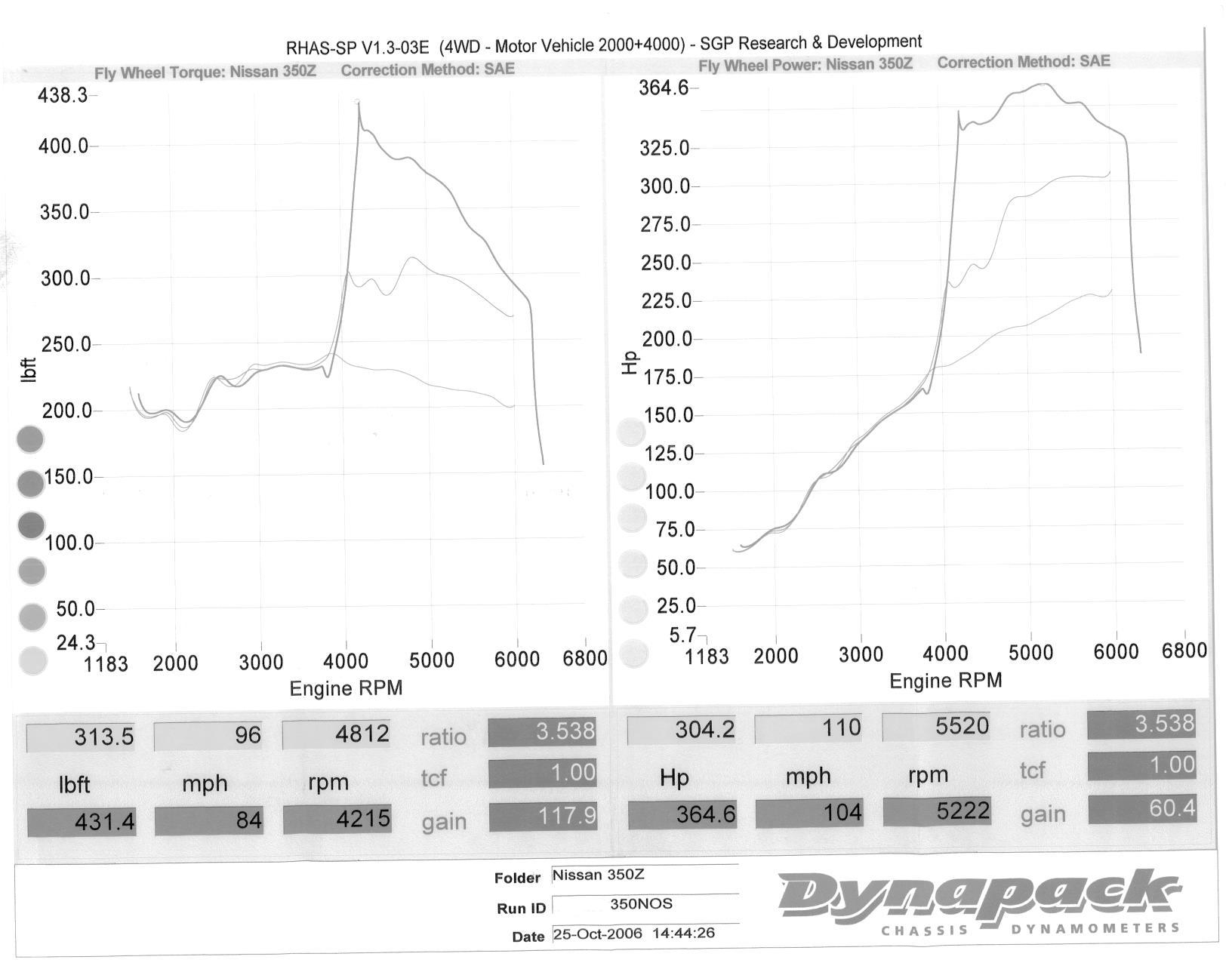

Nitrous IS bad.....real bad....lol.
stock block with breather mods and a UTEC....
nice! what size shot?
