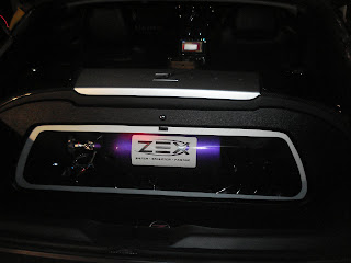

http://4.bp.blogspot.com/_L4b5t-25Fc...0/DSC02038.JPG
sorry, bad pic... but just an idea.
what mods do you have to get to 325whp N/A

thats a cool setup, pretty much thats what I had in mind.
