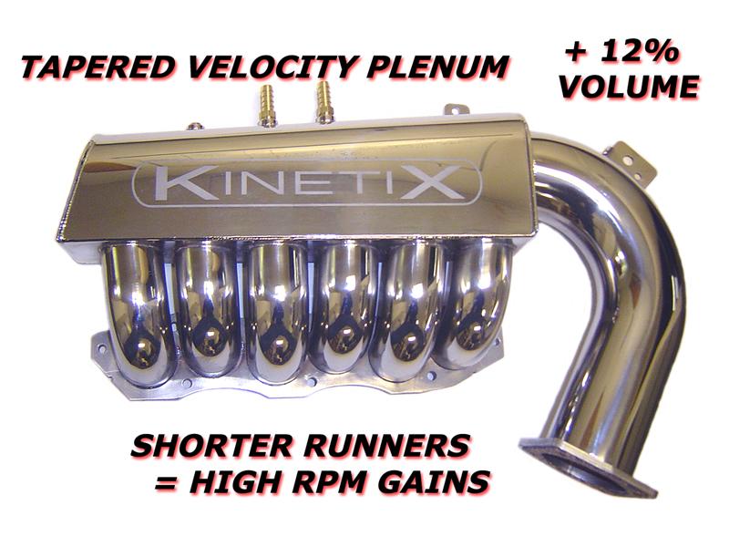

looking to put a 6 cyl direct port on the manifold for safer mixture... was wondering if anyone else has tried direct port on a vq35 before an what i should look for just looking for some positive feedback/ideas, ill be using up rev for tuning and changing to colder plugs

Any decent shop could weld some bungs onto the manifold runners and run the fuel and nitrous lines for you.
