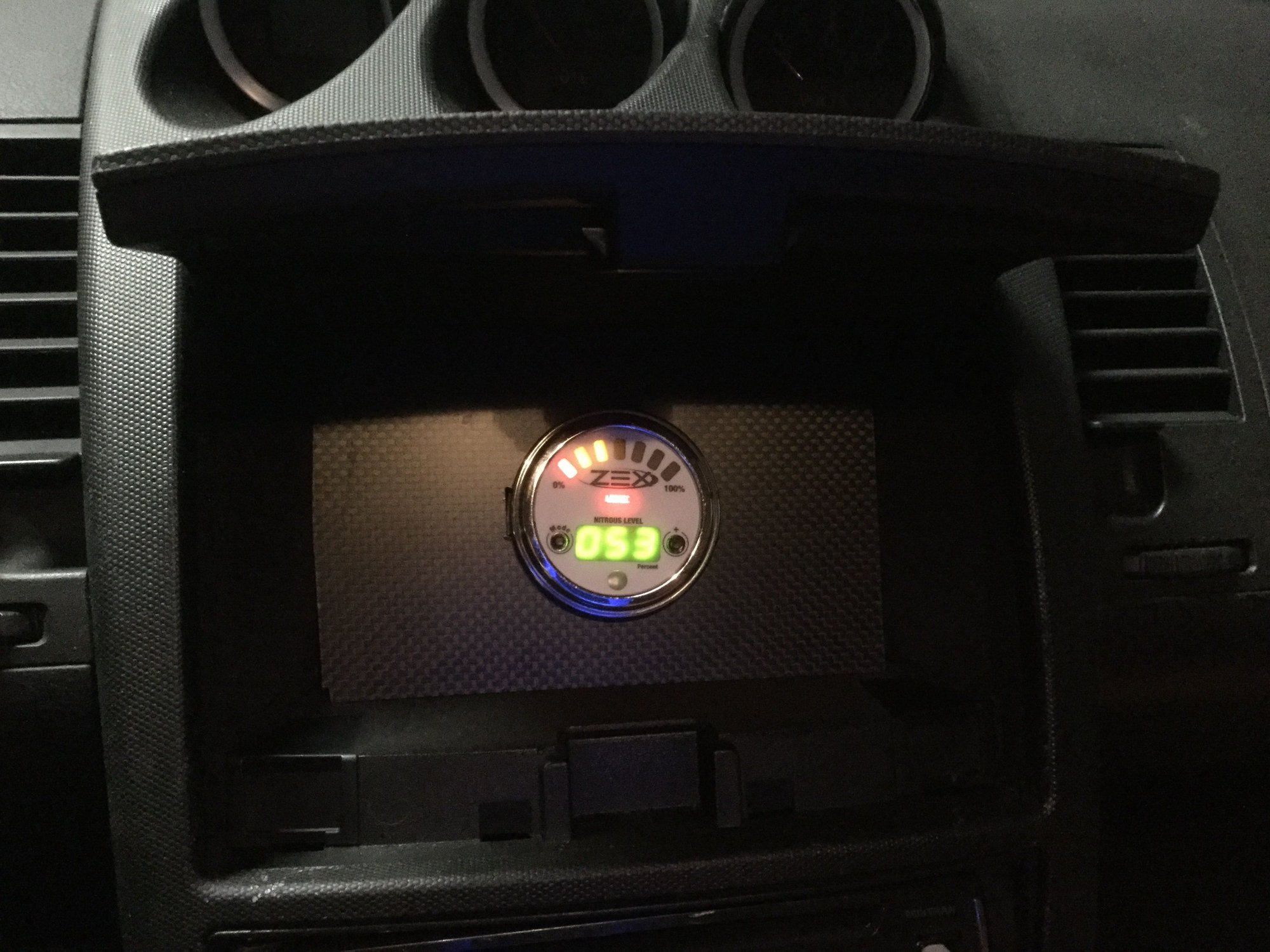

I also added the Zex nitrous fill gauge in cubbyhole. Well worth it.
