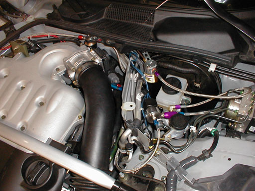

I've attached a picture of where my purge valve is routed. I mounted the purge valve in the brake fluid compartment and faced the Zex purge solenoid towards the firewall. The brass line exits out through the vent holes under the windshield wiper. You can see it in the top fo the picture.
