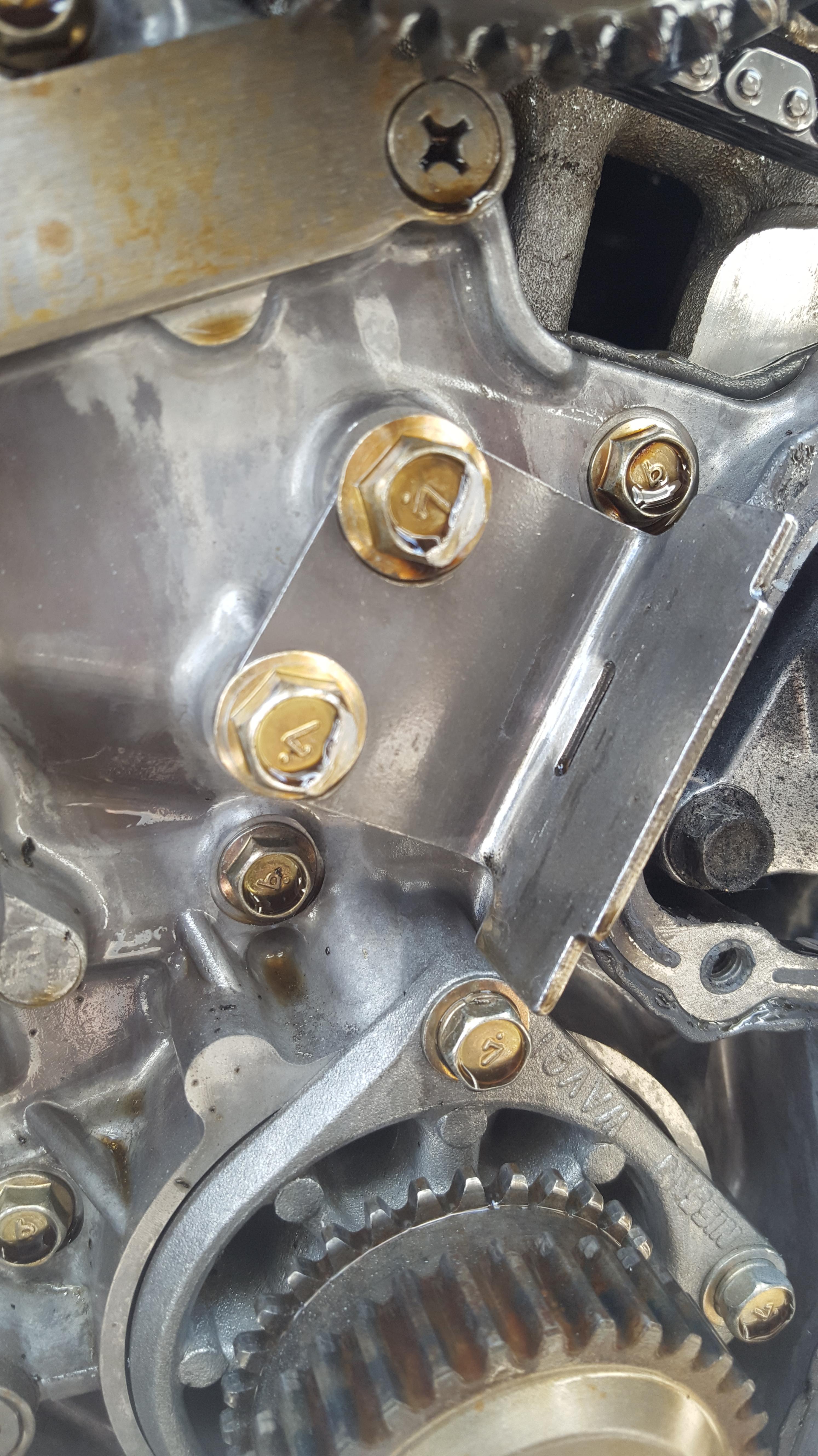

I'll try to keep this relatively short...
Well I made the jounrey to NC Friday night, and oddly enough things didn't go as planned. My drive down there was 480 miles. Car drove FANTASTIC the entire time, got to the last 1/4 mile before my hotel and I put the clutch in to coast and the car started to make a loud ticking and shut off on me. Very grateful it did get me to the hotel however (Lucky portion of this unlucky event).
Anyway started to tear into it with Ray Saturday morning and neither of us had ever heard of this issue before. Out of all of the parts Ive switched on my car, the failure mode turned out to be the only OEM portion of my motor, the timing chain guide. Again, never heard of this happening on a VQ. The black plastic part of the guide just came off of its bracket (mind you these parts have about 1200 miles on them because I replaced them when I built the motor). When that guide came off, it put slack in the chain, which then started to chew up some bolts, and this extra slack allowed the chain to hop over one of the timing gears.
After looking at everything with Ray, we determined all that needs to be replaced is the timing set. We were worried about the valves getting bent, but we compression tested and all came out good. So another slight delay in my car being done, but now I left it with Ray so he can do the timing again. So next time I go to get it, it should be done and tuned 100%.

Wow what a PITA. Good thing you can keep the car at RZG, good thing you made it to the hotel, and good thing you and Ray found the problem and it isn't an expensive fix.
I have to say you guys tore that thing down pretty quick.
I have heard of this happening to the VQ's. Typically it's due to neglect and oil level/life, but you may have gotten a faulty component in your case...

Yea it went fast. Got my car to RZG around 10AM saturday and by 11:30 we had it torn apart and diagnosed what needed to be replaced.
It's definitely just faulty, was driving very respectfully when it broke and that guide had 1200 miles on it. And oil level was perfect, that was the first thing I checked.

I am sourcing timing gears from a long block I sold to a local guy not too long ago because my timing chain chewed up my current gears

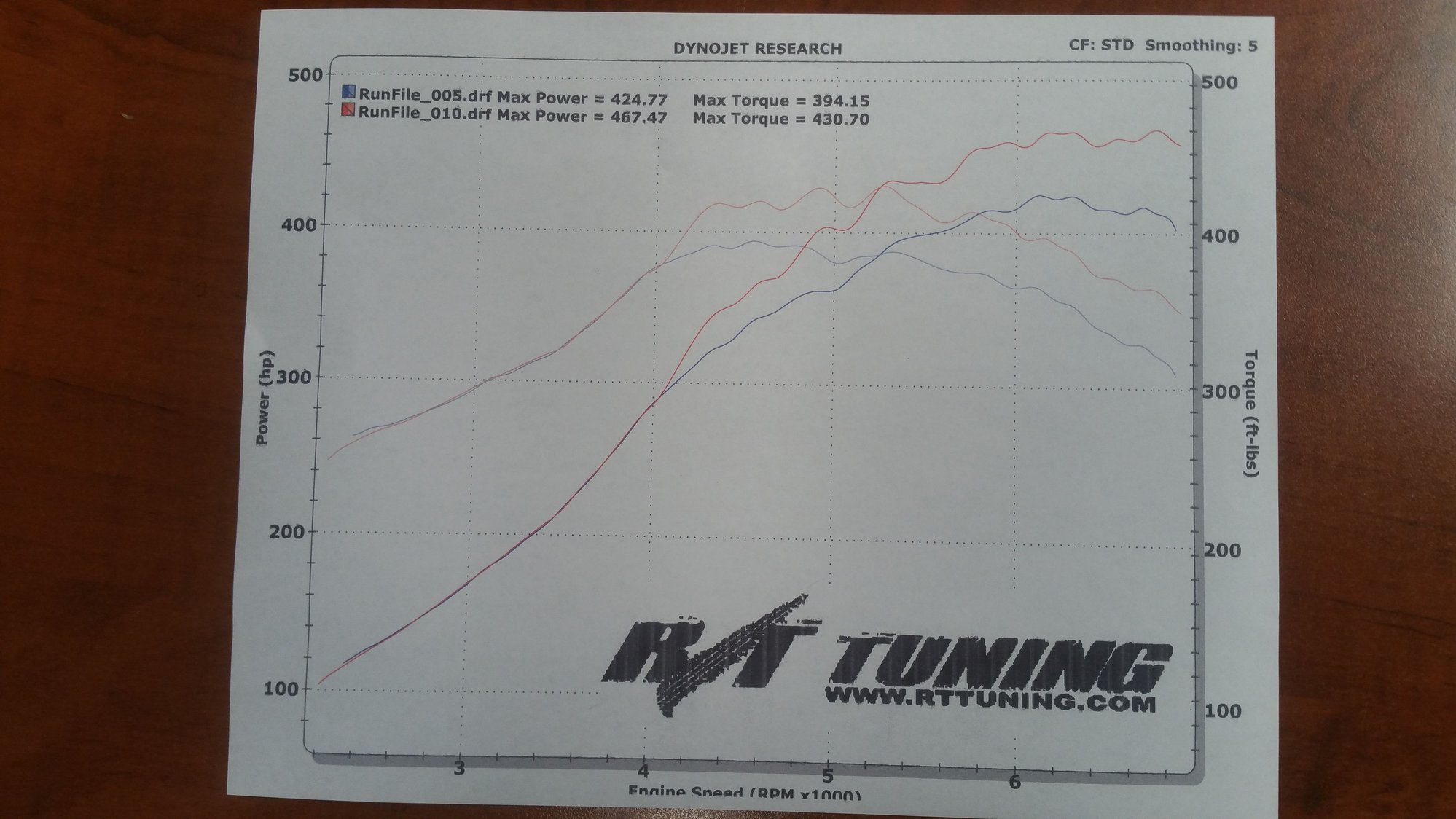

Default Success
Ended up making it to RT tuning and back successfully. Things went very smooth.
At one point we were at 485/435 but turned it down to 467/430 for longevity...
Very pleased with the numbers, and only cost me $730 yesterday on top of the $200 deposit.
Uprev ARC features work great. Antilag builds about 2 psi at the line. No lift shift is sketchy but works if you wanted to beat the **** out of the car. Rolling antilag needs some work, just makes the car shake a lot...
The car is hungry for tires in second and third. It sounds like a really mean car with the open dumps, cuz it is

Nice numbers..
Is that an oil cooler that peeks down below the bumper asking to smash road debris?

Lol yeah it is an oil cooler. I plan to get that higher once I swap my crash bar for a tubular one in the next few weeks.
