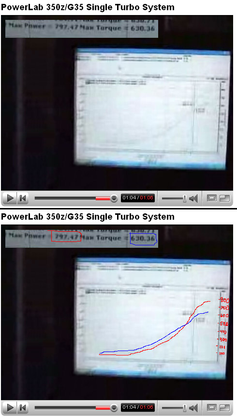

You can plainly see the dyno graph on the video posted in the OP. I know I've seen previous dyno sheets posted and the car has a 7.5k rpm redline.
Keep in mind the lines drawn on it are approximate...
that was witha huge exhaust leak on the whole left bank....
basically that run in the video was with a 1.75L 3cyl engine
That was also with the exhaust leak (and before VCT??). If it is spooling that 76 that slow then something is seriously wrong.
Just posting whats on the video.
But, I very much doubt it would be making almost 800whp with only the use of 3 cyl. But fair enough, as I dont think a T-76 would make much difference anyway depending on the sizing of the other turbo components. The garrett GT37R has a 76mm compressor wheel anyway I believe.
I seriously hope it makes power much sooner than that. I'd be more worried about the stock sleeves failing any given moment at those power levels.

If you have an pre-turbo exhaust leak, and nearly an entire bank is not getting to the turbo, it's not that the turbo won't spool. it's that it will take it a hell of a lot longer to spool.
Manifold pressure is manifold pressure, if you measure 25 psi it's still going to make what 25 psi would make, but if you have a leak it's going to take longer to make the 25 psi.
Right, I think it was more laughing at the car running on "basically" 3 cyl. We all know that's not true. Yeah, I'm interested in seeing how quickly the present turbo setup's power peaks. I'd imagine it would be no later than 5500rpms...
