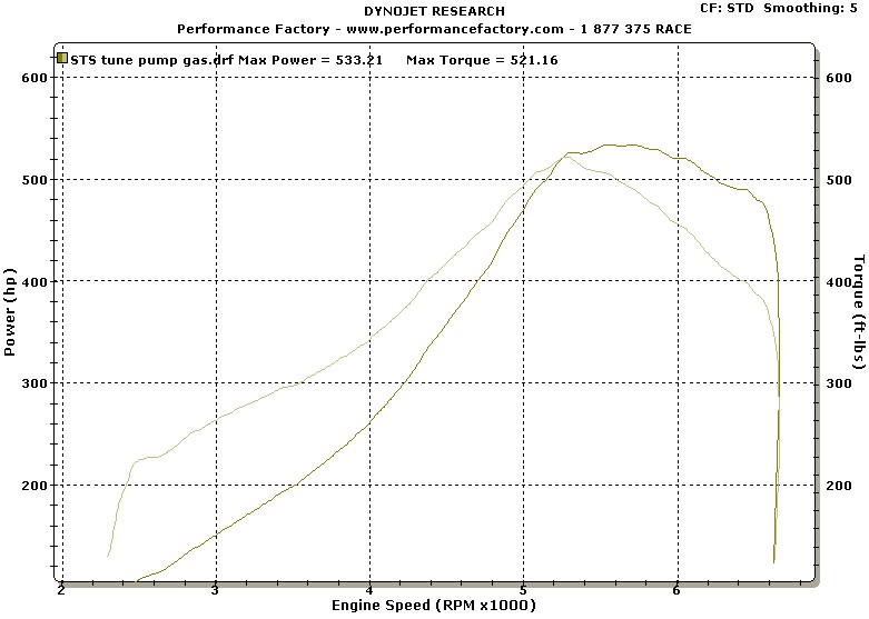

Now, Before people get all bent outa shape and talk alot of trash, we were using a .68 AR housing. I also have a .58 housing and we plan on switching to that to see if the power comes in sooner. However, even with where it currently comes in, its great. No matter how hard I get on it, the tires don't spin. The power comes in easy and the car just takes off.

Cool videos. Nice graphs. Enjoy the car.

The Turbo he has now is capable of up to 750hp so with the smaller a/r he will be within where the power will actually benefit the Motor without having to run more boost. Right now he has more top end that he is not even close to seeing so if he goes smaller on the turbine side he should be seeing the power sooner and it will be more usable. The only way he will choke out the .58 is if he had a bigger Motor or more RPM so he should be fine.

me no like the power curve
