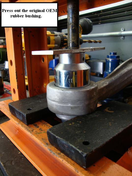

Thumbs up Spl front compression arm bushing install!
REMOVE THE UNDERBRACE:
USING THE SOCKET ACIDJAKE BOUGHT - AS SHOWN IN THE SPL INSTRUCTIONS,
PRESS OUT THE OEM RUBBER BUSHING:
OEM RUBBER BUSHING REMOVED FROM COMPRESSION ARM:
REASON FOR REPLACEMENT - TORN!!!
HERE IS THE DAMAGE: TORN COMPRESSION ARM BUSHING, IE BAD CASTER!

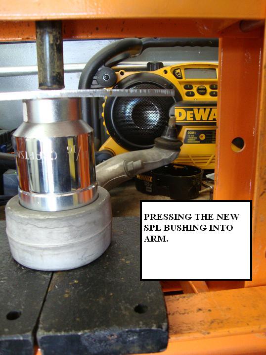

BEFORE PRESSING IN THE NEW SPL BUSHING - YOU MUST MEASURE TO ENSURE PROPER PRESS FIT:
NOW TIME TO PUT THE SPL BUSHING IN:
COMPRESSION ARM MUST BE ORIENTED WHERE RECEIVING TAPE IS UP TO ACCEPT THE BUSHING:
PRESSING THE SPL BUSHING IN:
SPL INSTALLED:
I USED BLUE TAPE TEMPORARILY TO HOLD THE BUSHING CONE IN PLACE WHILE I PUT THE BRACE BACK ON:
DONE!
BACK ON THE CAR:

No more caster issues for me!!! Woo hooo!!!!
I plan on getting my alignment sometime this week....
Car steering response is smooth......i didn't honestly expect that at all.....i guess the oem blown rubber bushings were causing way more friction and steering effort that I honestly expected...
car turns super smooth and effortlessly...

ya, went well.......press socket was key. Im looking to make my own via steel so we can return the pricey socket..
