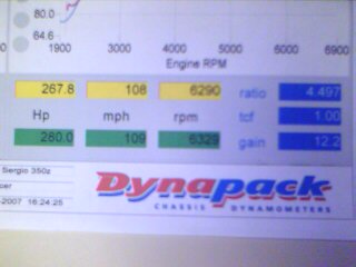

Did you real time tune it or just run a tune out of the box?
Each motor is slightly different in terms of what it likes on the fuel side so a real time tune with back to back runs should provide you with better results IMO
FWIW the first pull after my TBS was 5hp higher than my previous baseline....as the ECU learned I gained even more....but I also have a popcharger (cant say whether that helps but it may be a factor)...I am also on the higher side of gains seen for a TBS and all the gains were topend with that thing (stock map)
