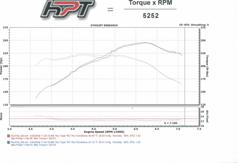

got my car tuned a few months ago by uprev and they did that thing that keeps my throttle body open 100% all the way to redline, and set my afr's to 12.8. New dyno is showing that i drop down to as rich as 12.3. Now for some reason it feels as if my car pulls better with only about 3/4 throttle as compared to WOT.... could it be that i am getting too much air in and maybe nissan made the TB close about 20% up top for a reason??? even though shouldnt the tune have been able to correct the "bogging" with the extra air????
wheres the street tuner already?!?!

do you have any data logs with more info? ecu may be pulling timing?

have you added any mods since the Uprev tune?
Was the first tune actually done at Uprev on a dyno, or was it one of the mail-in tunes?

no other mods since uprev tune. yes it was done at uprev in austin texas on a dyno. I dont have any data logs because they didnt give me a cypher when i got tuned...
