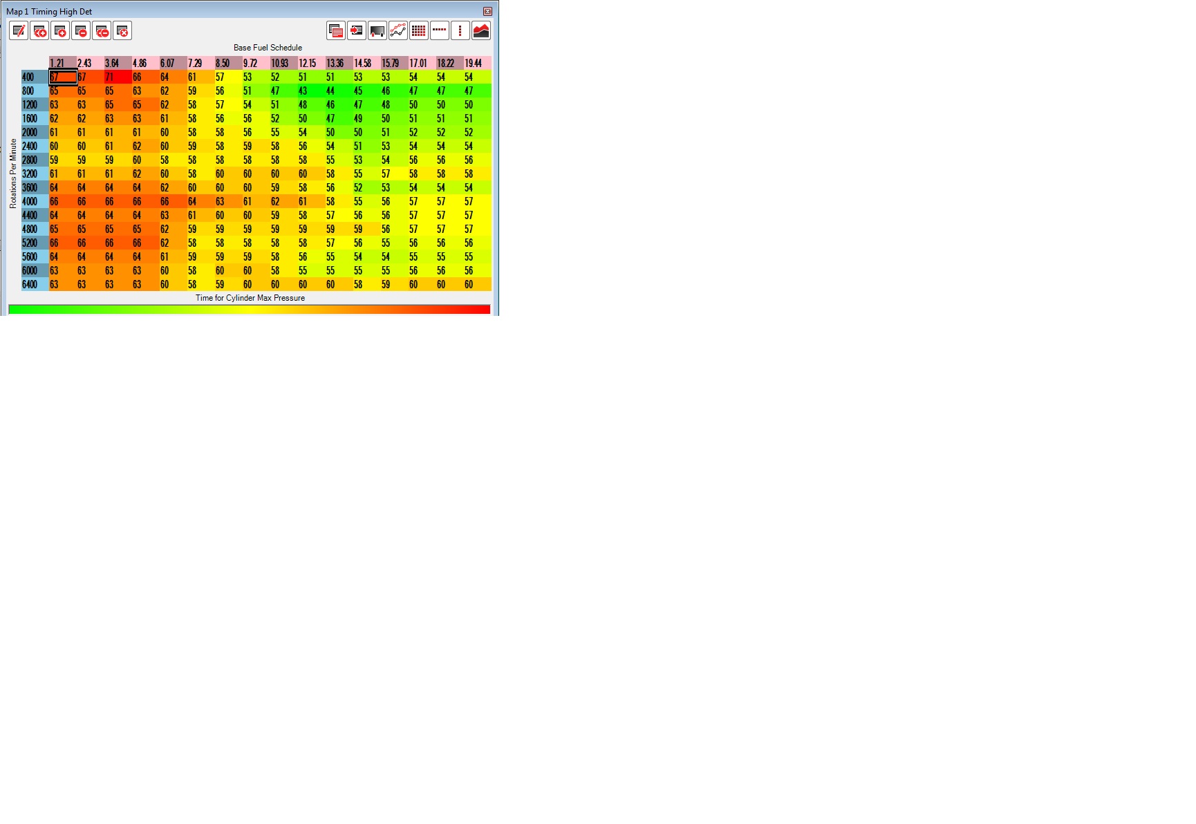

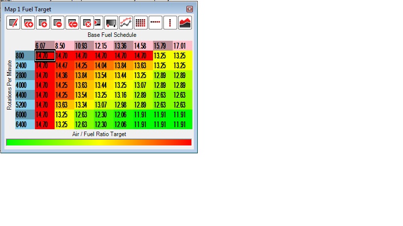

Thats great news, ok heres my list of goodies on my car,
03 g35 6mt coupe:
-t3/t4 rear mount turbo
-600cc DW Injectors
-LC-1 Wideband O2
-JWT FMU (3.7:1 In-tank fuel regulator)
-Walbro 255 Fuel Pump
-Upver Osiris Tuner
-NGK Iridium spark plugs, Heat level 6 (1 stage colder then stock)
-Intercooler (fan-cooled) with a pre-cooler pipe)
Thats all the relevant stuff i can think of, this is as of now a lil over a year old prodject which is starting to look good after a whole bunch of small problems being worked out one at a time. I had the car tuned on the dyno by an anonymous place which I wont mention if you guys dont mind, since ill be sharing the info, plus I dont want to have bad nor good things being said about people based on my info.
The tune (rom) the car drives on now is from a dyno tune with me just making a lil tweek at the target afr table. Once tuned, the car ran very well at wot, but in mid throttle range it was running lean. By that i mean, for example, in 3rd, 4th, 5th, and 6th gears, at half throttle anywhere from 2500rpm and up i was seeing full boost 5-6psi, but the Wideband 02 read 14-15afr and car was feeling very sluggish and sometimes i even heared crackling noise which would go away as soon as id put the pedal to the floor and afr's would drop. Once i saw the target afr table, i saw that it was set to 14.7 at low to mid load areas of those rmps, which i lowered to high 13's and now the car runs a lil rich (10-11 afrs) at those same areas and even full throttle its below 11afr which is weird cause i didnt change any numbers at higher loads. I haven't touched the timing since i'm not sure its good or bad, but the car feels much stronger in mid throttle range now and feels like it got better then worse since my changes were made.
I would like to build my own rom from scratch at some point when I feel comfortable, but for now perfecting this one it my priority. The compensation table doesn't looks like it was reset to all 100's and the numbers on it are all between 87 - 94, ill post pics and u'll see what i mean. So thats my story, i'll try posting all my rom info now and again I appreciate your guys help more then you can know. Im not sure how I'll fit the whole MAF map, ill prolly have multiple pics of the map spiting it into 1-3 screens. So have a look and dont be shy to speak your mind lol.

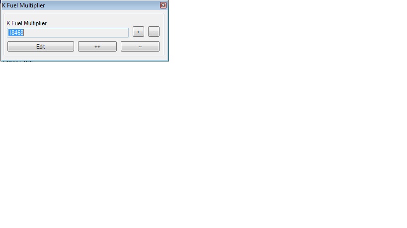

Old Aug 21, 2011 | 12:14 PM
  #105
mgs1849's Avatar
mgs1849
Joined: Jul 2010
Posts: 16
From: CT
more coming...
Attached Thumbnails Wanted: UpRev Tuning DIY - Tuning 101?-k-fuel-multiplier.jpg   Wanted: UpRev Tuning DIY - Tuning 101?-maf-voltage-air-flow-table.jpg   Wanted: UpRev Tuning DIY - Tuning 101?-compensation-fuel-table.jpg   Wanted: UpRev Tuning DIY - Tuning 101?-target-fuel-table.jpg   Wanted: UpRev Tuning DIY - Tuning 101?-minimum-injector-latency.jpg

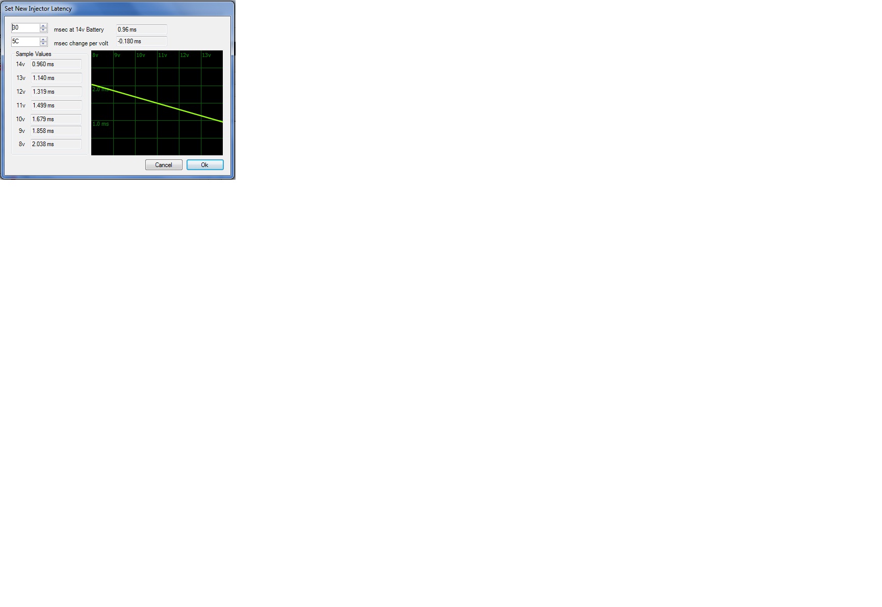

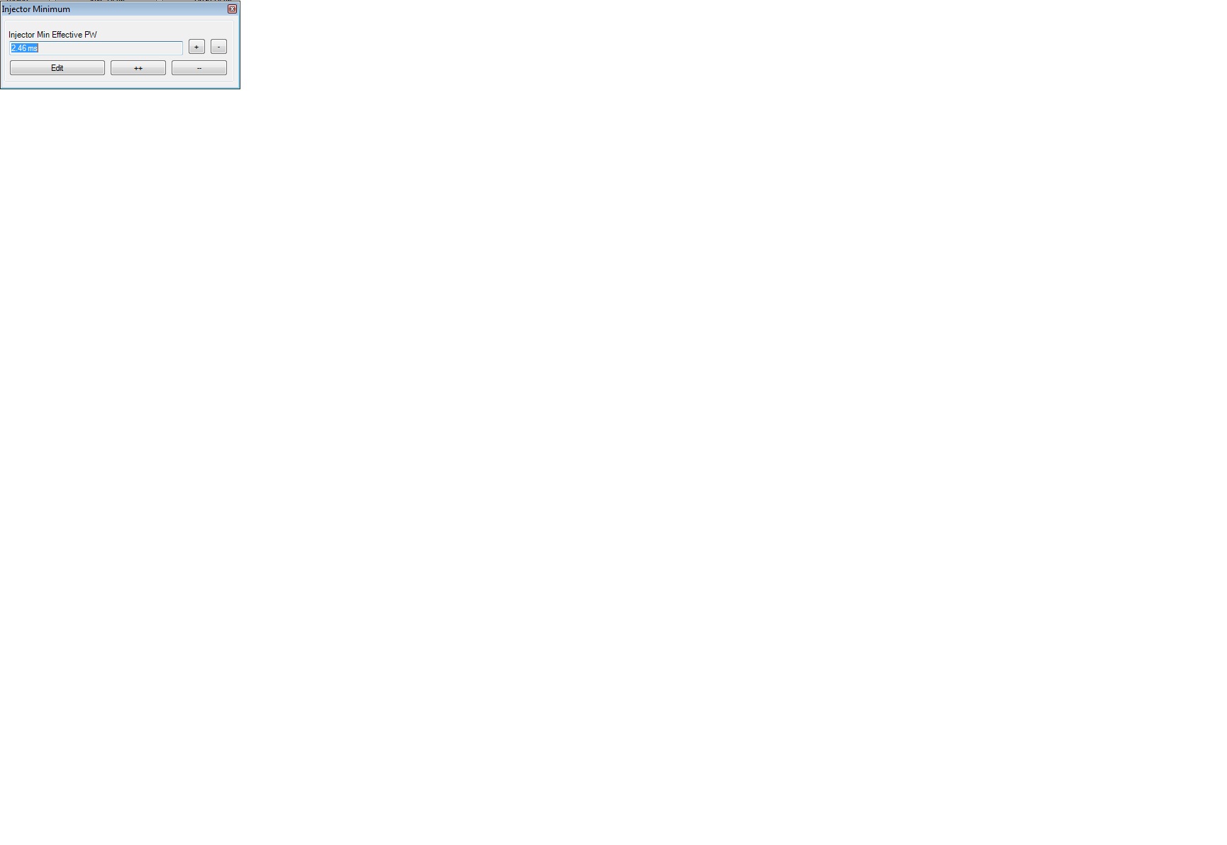

Old Aug 21, 2011 | 12:28 PM
  #106
mgs1849's Avatar
mgs1849
Joined: Jul 2010
Posts: 16
From: CT

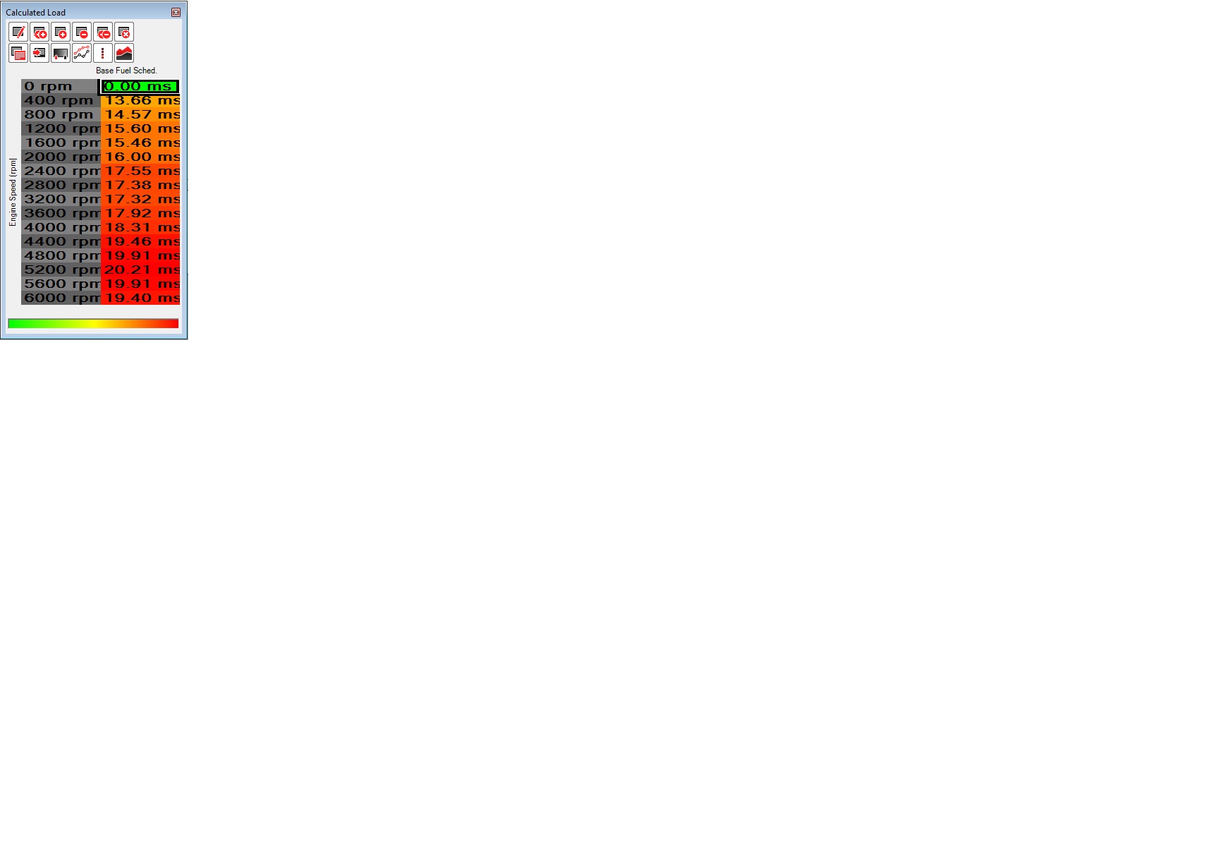

The troble code dissabled image shows a single DTC code that I had come up because theres a small warm start stalling issue that i have that trips this code, i would also like to discuss this with you guys and see if we can resolve it together. If theres other tables that you want to see, let me know which ones and ill gladly post them. Cant wait to hear your thoughts.
Attached Thumbnails Wanted: UpRev Tuning DIY - Tuning 101?-calculated-load.jpg   Wanted: UpRev Tuning DIY - Tuning 101?-injector-latency.jpg   Wanted: UpRev Tuning DIY - Tuning 101?-main-timing-table.jpg   Wanted: UpRev Tuning DIY - Tuning 101?-timing-high-det-table.jpg   Wanted: UpRev Tuning DIY - Tuning 101?-troble-code-dissabled.jpg
Old Aug 21, 2011 | 05:41 PM
  #107
Vince@R/TTuning's Avatar
Vince@R/TTuning
Vendor - Former Vendor
Joined: Jun 2009
Posts: 505
From: Lansdale, PA
Not sure if you said that the last Osiris tune was from a shop but I hope it wasnt. From what ya listed half the values dont seem right and the other half def arent right. The air fuel target table isnt scaled real nice and the fuel comp table should be set closer to 100.
I think the biggest issue is that the high det ignition table you attached actually has higher timing values then your main timing table...and thats not good at all.
Not sure where everything stands with that ROM you got and if it was a shop that performed the tune but I hope it wasnt a Pro tuner....
Old Aug 22, 2011 | 07:16 AM
  #108
djamps's Avatar
djamps
Joined: Dec 2008
Posts: 4,492
Likes: 10
From: MD
Your entire tune is terrible, wrong in so many ways. Like Vince said the timing tables were done backwards...among other things that don't make sense.
I wouldn't continue driving it if I were you, that crackle sound is detonation which will likely end up with a bent rod or hole in your block.
On a side note I'd ditch the FMU -- the 255 walbro and 600cc's should be enough to handle your kit. The FMU will just make tuning alot harder.

it was a shop that did the tune, and on the dyno, and i had a feeling it wasn't done right which is why I'm attempting to resolve it myself. The crackling doesn't happen anymore since i richened the target afrs, and believe it or not the car doesn't feel half bad now, but im seeing 10:1 afrs, at all times between 0-6psi. I guess the next order of business would be, to see what my next step is. Id like to make my own rom from scratch if its not terribly hard, and I could supply logs for info. Ima get a log file made with this rom and post it just to give you guys an idea of what the cars doing, just let me know what parameters i should include. Ill unplug the fmu if its an issue, its not difficult at all. What should I be setting my k value and injector setpoints to now since you guys know what i have?

Basically you'll want to re-tune from scratch. Don't use any part of that existing tune.
The uprev manual has quite a bit of info in it on how and where to start. I suggest getting a fresh stock uprev rom and start with the basics... idle, free revving, ect ect then work your way into tuning the higher loads once you are familiar with things. I would also recommend removing the FMU before you get started -- it was designed for the stock injectors, not to be used with your 600's. It shouldn't be needed for <10psi and it's going to make mid-throttle tuning difficult. Just leaving it disconnected will hinder the flow.

It took some trial and error but I got plenty of info from uprev manual to get me started. If you want people to give you numbers to plug in (other than statics like injector latency) you probably shouldn't be attempting this yourself. No two cars are alike so just plugging in some value and running with it is a big no-no.
Page 23 of the manual -- it said to 'find' your K. In otherwords, adjust it until it with Cipher (live tuning) until it idles ~14.7.. The only change I would make is start with the PMAS MAF installed... I found when I changed my stock one out everything went to **** and I ended up starting over anyways. Keep in mind when live tuning in Cipher, nothing is saved to the ROM. Before you exit Cipher, save the tuning data to a file, then import it into your ROM file in ROM editor and reflash. If you don't do this after making changes with Cipher's live tuning, you'll lose the changes as soon as you change maps or disconnect the battery.

i understand what you mean, and I have a general idea of what i'll need to do, can you give me the injector latency and w/e other injector settings you can? This way i can get started. Ohh and do i have to have the other maf, or will my stock maf be able to handle 5-6 psi. I was told it would be enough since im not going crazy with the boost. And every time i try to make adjustment in cipher, when i got to drive the car, the gas pedal looses control of the throttle body. I can press the peday all the way to the floor and i wont rev at all. If i shut the car off and start again it comes back until i try putting the car in gear. Its weird why it does that, but ive just been using rom editor to make live tuning adjustments. The issue doesnt occur with rom editor. But yea, if you can provide the injector info for me that would be great. Thanks

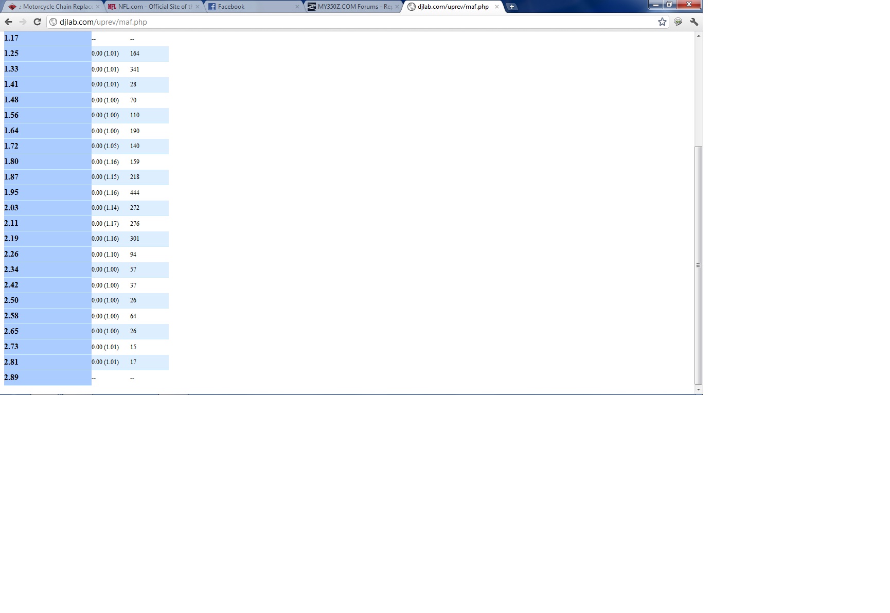

Old Aug 24, 2011 | 06:11 PM
  #119
mgs1849's Avatar
mgs1849
Joined: Jul 2010
Posts: 16
From: CT
so I spent a few hrs trying to use that tool to dial in my maf, and i'm kinda lost. Seems like the car does different things at same voltage. I was just sitting in my drive way revving my engine trying to get the afrs stable but no such luck, heres the log file if anyone wants to look at it, the injector latency is same as before, min injector pulse width changed from 2.46 to 1.54, and k value down from about 18600 to 16450. Thats the first log file. The second log file labeled "latest log" is the original map with richened target table, min inj. pw at 1.54.
I'm impatiently waiting for those screen shots from djamps lol. Any feedback is welcome.
Old Aug 24, 2011 | 06:28 PM
  #120
mgs1849's Avatar
mgs1849
Joined: Jul 2010
Posts: 16
From: CT
here they are
Attached Thumbnails Wanted: UpRev Tuning DIY - Tuning 101?-first-log.jpg   Wanted: UpRev Tuning DIY - Tuning 101?-latest-log-part-1.jpg   Wanted: UpRev Tuning DIY - Tuning 101?-latest-log-part-2.jpg
