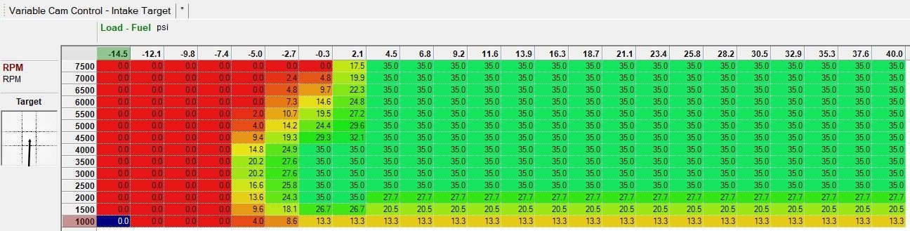

I stole this from Ecutek but the values on mine should match these.
I'd like to see a map that was tuned for boost just to get an idea of the maps shape as this map has a lot of advance in the boost building areas where I'm used to these values being zero or close to. Thank you again for your rely bealljk.

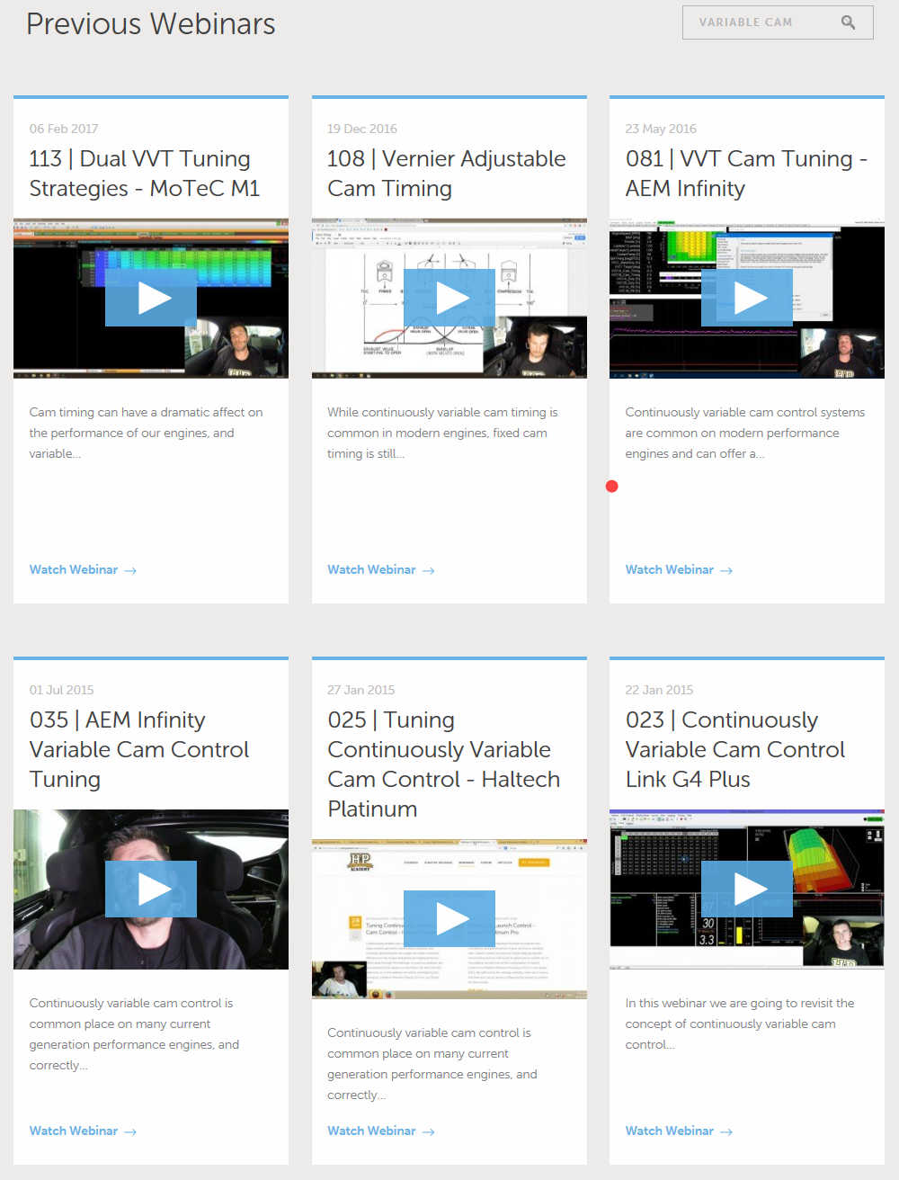

my go to for anything tuning / engine building is HPA - these are their webinars on variable valve timing tuning. May be worth looking into a subscription if you want to get deeper into tuning.
I don't think youre going to find anyone that has a variable cam map tuned for their car. Of my three tunes I've done the tuner wasn't interested in tuning the VVT and I think they don't know enough about it. On my Haltech and on the Link I've used their canned maps for VVT.

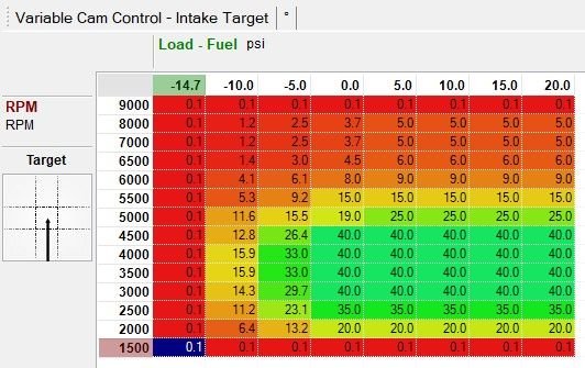

Use discretion and at your own risk:

Those first two maps look like what I expected to find for boost, the second two look like NA maps. I'll try shifting the maps over like those and log the maf voltages before and after. That should give me a pretty good idea of where it's helping and where its hurting. Thanks for all your help.

The bottom two are from the template base file in each Link and Haltech.
