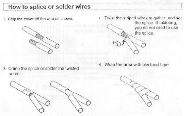

i have to solder? darn. looks like i'll have to pick up a gun and start practicing. how hard is it? it just seems liek u put thetwo wires together and then u use lead or whatever and melt it on top..?

lol...umm...I guess that's it in principle....a little more involved than that though...I'd suggest some practice
Well, as Wes said, you have the basic principle down, but you need to really practice to get a good technique. Here's a picture from the GReddy eManage manual that shows how they recommend the wiring be soldered together. The important thing to note is that you don't actually cut the wires in the ECU harness (well, the MAF sensor wire is cut, that is the exception). You just have to remove the wire cover and then twist the eManage wire around it, then solder it well and wrap in electrical tape.

That's the old resistance soldering idea with a new marketing twist. I wouldn't use it on any wires connected to sensitive electronics (like your ECU). What you want is a 25 watt ESD safe temperature controlled pencil iron from Weller, Ungar, Metcal, etc.
I use the Weller WTCP solder station for this sort of work.

I use a 15 Watt with .020 gauge solder. Works like a champ and is safer for sensitive electronics due to lower heat.
