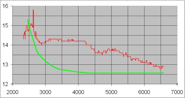

Well, after talking to a few people, I found out that connecting the RPM signal wire of the Zeitronix to the GReddy RPM Signal adapter was not the best idea because it was causing my RPM numbers to be extremely jumpy. I hooked it directly Pin#62 of the ECU and BAM! Signal is good now. I did a couple WOT 3rd gear runs last night and imported the data into Excel and created a graph of my current A/F ratio under WOT. The red line is what the A/F currently is, and the Green line is what I am aiming for when I start tuning the eManage this weekend.
Now I just need to determine how much I need to add in the eManage Injector map to make a difference in the A/F at specific points.
