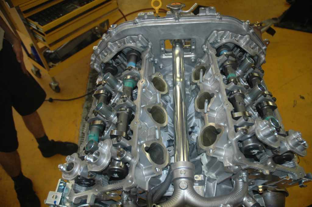

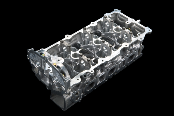

Hope these help.
Attached Thumbnails Help. I need HR Cylinder Head photos-nissan-vq35hr-engine-06.jpg   Help. I need HR Cylinder Head photos-nissan-vq35hr-engine-07.jpg
Old Aug 3, 2009 | 10:00 AM
Swimminggerman's Avatar
Swimminggerman
Joined: Oct 2007
Posts: 567
From: Ohio, Cleveland
looks great, hope it'll work for them. How did you get these or know they are for the HR? though now im thinking i might need numbers/specs. More research time i guess. But if anyone has anyother photos I would greatly appreciated it.

I got them from a thread that was about the VQ35HR engine posted I will try to find it for you.
Old Aug 3, 2009 | 10:20 AM
plumpzz's Avatar
plumpzz
Posts: 7,146
From: Jersey, New
That is the HR. The extra cooling channels on the block show it.

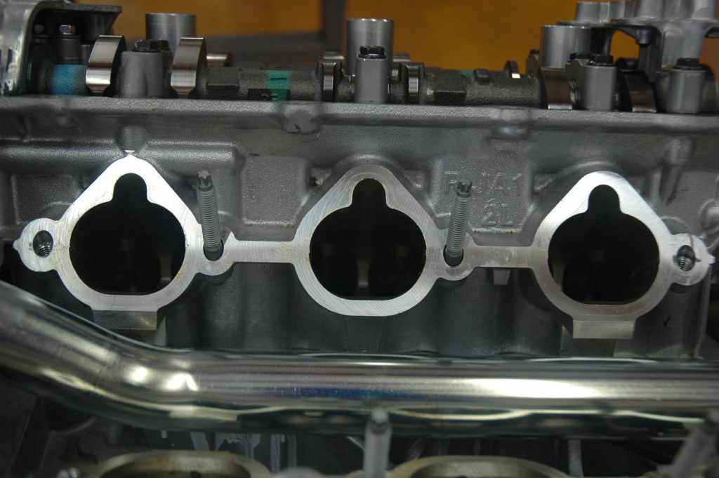

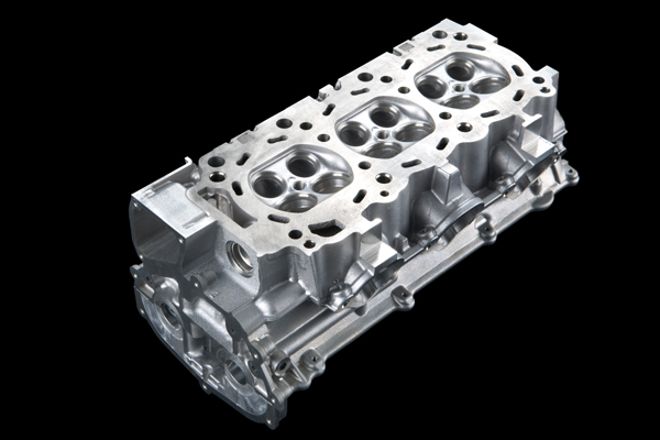

Ok now I need to find a way to compare the DE and HR cylinder heads. Many say they are different, however They look very simmilar if not the same to me, Jenvey had also mentioned they looked simmilar. Id like to know if anyone has for certains on this and compared them. Im going to try and contact forged and Z1 about this. Any others please feel free to add input. These are photos of what Forged performance took when they first tore apart the HR. Any DE photos out there to compare to? Or individuals with truth/knowledge? Thanks
Attached Thumbnails Help. I need HR Cylinder Head photos-dsc_4570.jpg   Help. I need HR Cylinder Head photos-dsc_4569.jpg   Help. I need HR Cylinder Head photos-dsc_4565.jpg
Old Aug 4, 2009 | 10:23 AM
warmmilk's Avatar
warmmilk
Joined: Nov 2006
Posts: 2,921
From: Seattle (area), WA
they are very similar, but at the same time different. in initial press releases, nissan said that the only things brought over to the hr from the de is stuff like nuts, bolts, and fasteners. iirc the bore spacing is still the same, but i could be wrong on that one...

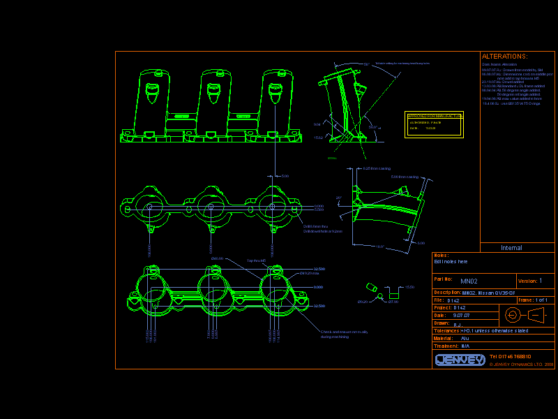

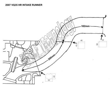

Ok I've got permission from Jenvey to post their image of the DE intake with measurements. Has anyone measured the HR's or compared them to the DE's? Id really hate to take my plenum off for measuring when I'm sure someone else might have already done this or has their plenum off. The thread kind of died after a few days, so hoping this will assist in getting more attention and assistance. I've never taken off my plenum HR, how much of a pain and time would it be? Thank you in advance.
