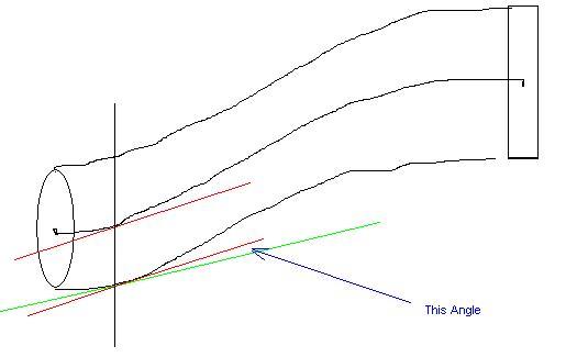

Originally Posted by GAMERMODZoCOM
I just realized what you are talking about. The runners from the lower are square and they made round runners to come in to the upper. Not really sure why they did this. Maybe they were just trying to beat S&R? I can't believe their design was flow tested in a CAD program before it was made if they went with round runners on top of square holes.
Maybe because the round runners would look nicer than the square runners

The answers to many of your questions, even the square per round hole one can be found in C.F. Taylor’s books “The internal combustion engine in theory and practice” volumes 1 & 2.
In a nut shell the transition from round to square and back again or vice versa will have little or no effect on air flow so long as the transition from one to the other occurs at an angle of less than twenty degrees.

Can you explain the 20' from what?
if i have a 2" diameter round tube going into a 3" square tube, where does 20 degrees work into the shape?

The round runners/tubes shouldn't mate to the square ones as-is; there should be a transition of a sort. So, I assume the 20º is referring to the angle of said transition.
Red lines are parallel lines, with one being tangential to center line. Black line is imaginary centerline through tube. Green line is tangential to wall of tubing.
This one is only in 2 dimensions, but can be expanded to 3 dimensions. Please excuse the crude drawing.
Attached Thumbnails Someone is working on an intake manifold for us-transition-angle.jpg
