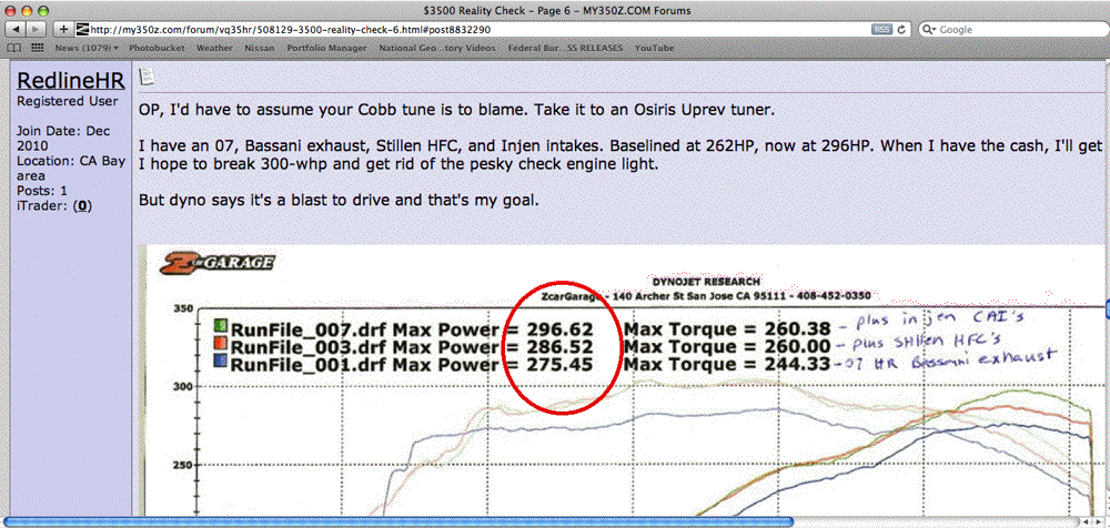

Originally Posted by AadosX
Exactly. It doesn't matter how high the numbers are. It's the SPREAD that you're interested in... and it doesn't matter what dyno you use, the spread should be the same.
Agree. 296.6-275.4=21.2. 21.2/275.4=.076 or a 7.6 percent increase in horsepower. If I was a dyno racer this is the number I would look at.

Right, and that's not including the 13 whp his exhaust got him.

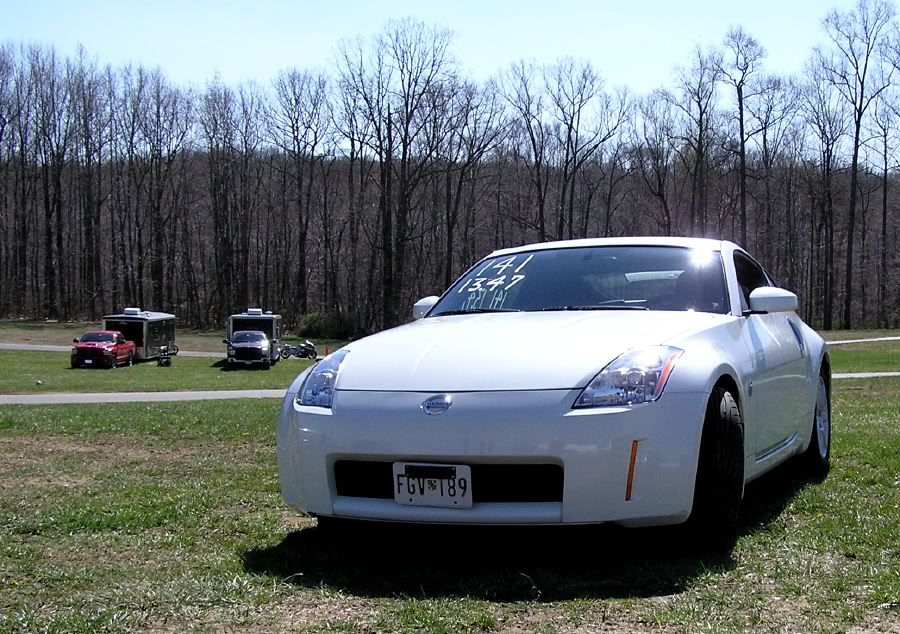

Of course they do. just not for the 1/4 mile dyno racers... Here's mine:
And here's how we use the helmet and mods

. . omg . . sweetness . . redline . .ur Z is clean as fack

Thanks SRS. I prefer the street setup with PS2's and LE37's, but I'm too paranoid to use that setup at the track so I use the stock GT wheels and tires... If I bend the stock wheels, I don't care so much.
