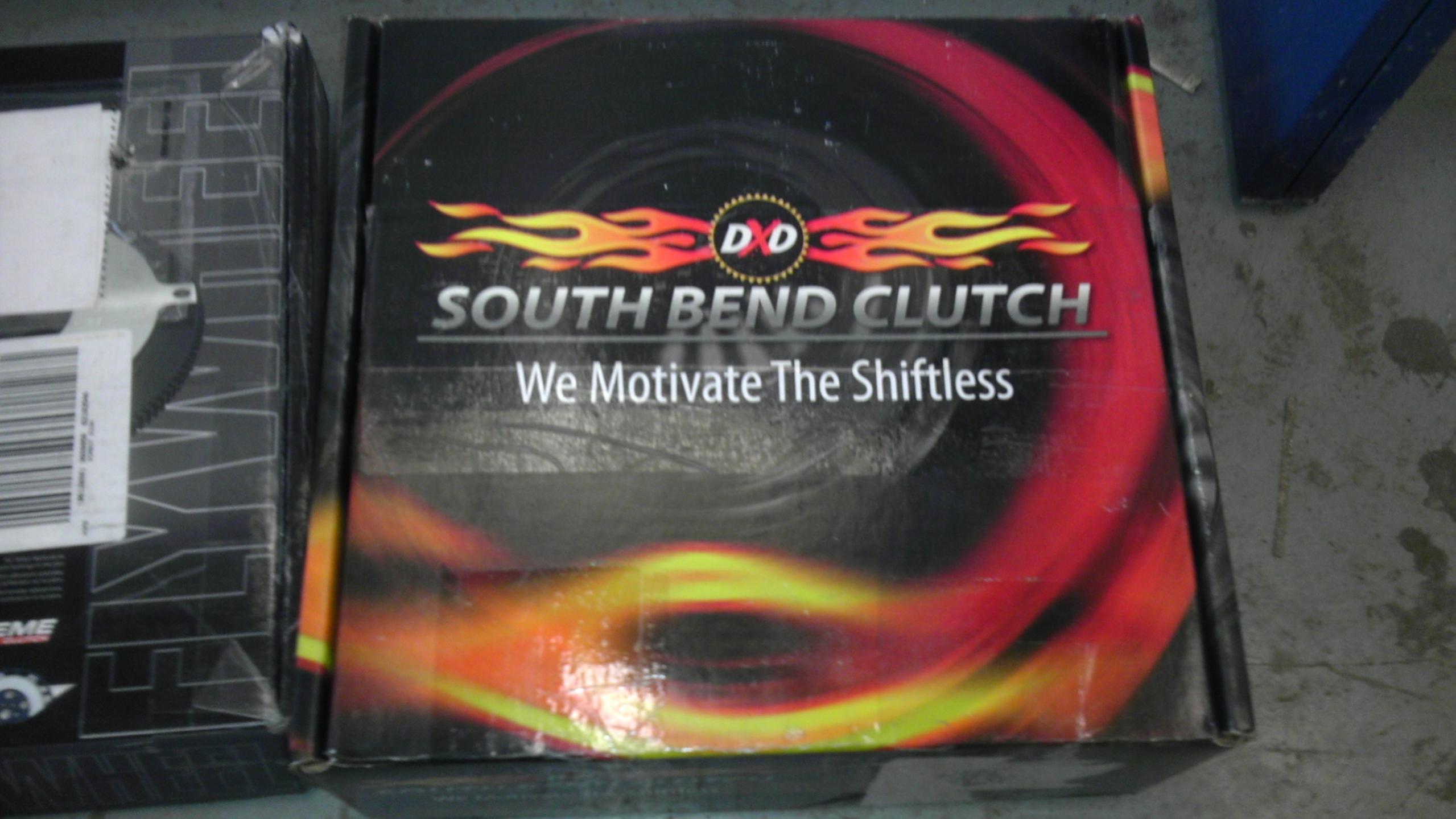

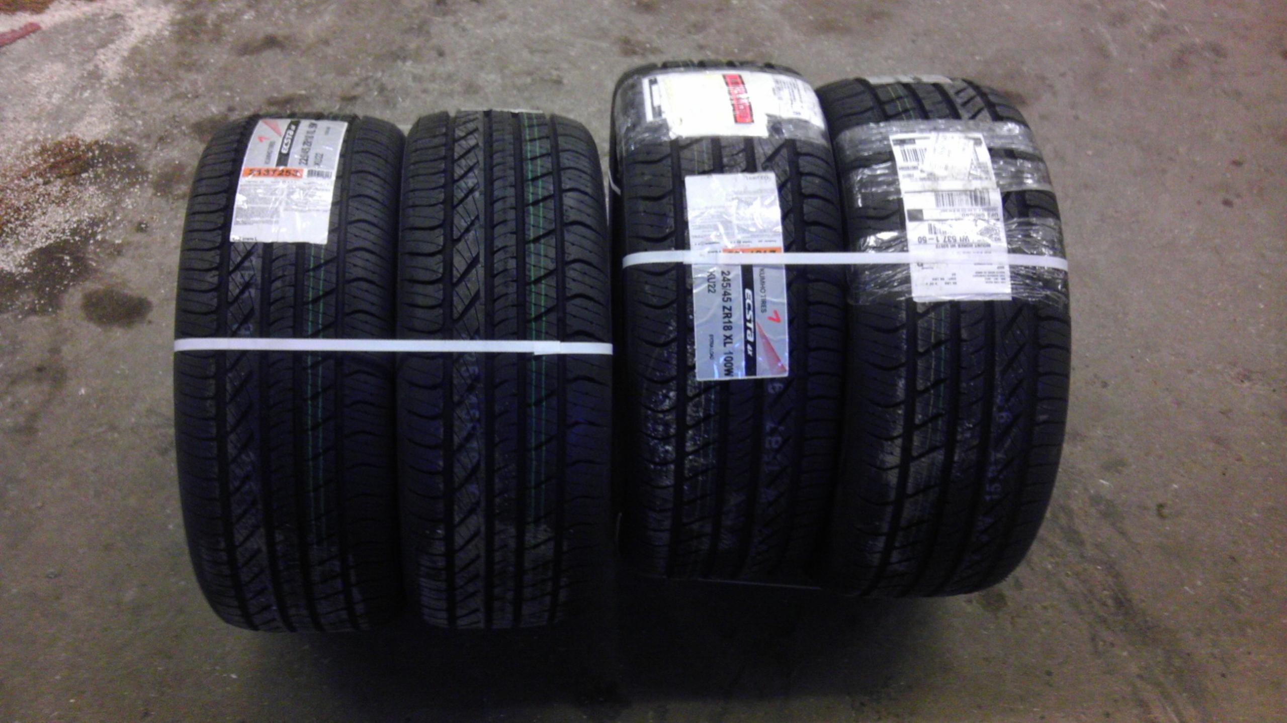

Finally got around to ordering my stuff...
I ordered all my parts from Joe @ ZSpeed Performance I really liked dealing with him and encourage others to do so. Thanks Joe.
ACT Streetlight Flywheel
Southbend (Stage 1) Clutch disk (EXEDY)
Southbend SS Pressure plate (Heaviest)
Z Speed Heavy Duty Concentric Slave Cylinder
Flywheel to crank bolts
MT-85 Gear lube
Motul brake fluid
Hawk HPS pads front & rear
Kumoh Ecsta 4x Tires (from tire rack)
I will stop back here to post my new thread once I have details on the install.
Attached Thumbnails New: Clutch, Flywheel, HD CSC, Brake pads & Tires-imag0002.jpg   New: Clutch, Flywheel, HD CSC, Brake pads & Tires-imag0016.jpg   New: Clutch, Flywheel, HD CSC, Brake pads & Tires-imag0018.jpg   New: Clutch, Flywheel, HD CSC, Brake pads & Tires-imag0010.jpg   New: Clutch, Flywheel, HD CSC, Brake pads & Tires-imag0013.jpg
