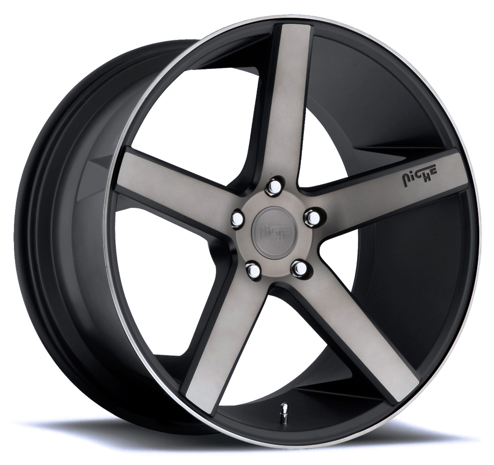

I don't know how many threads I have read on wheel offsets, offset calculator, tire calculator but I can't find the answer to my question...
I got Niche Milan wheels for 2008 Z, stock suspension and everything. All I want to know is whether they will fit. About to order tires this Friday as well. If someone could help me out...that'd be great cuz at this point I am just thinking of giving up and selling those rims and not change the wheels anymore.
The specs are:
FRONT: 19x8.5 +35 offset
REAR: 19x9.5 +35 offset
Tyres will be:
FRONT: 245/35/19
REAR: 275/30/19
ANY spacers I should be using to not have the rears and/or fronts collide with the suspension? I checked and the offset calculator says that the rears will go inward about 15mm (~0.59 inch) and extend outward by 11mm(~0.43 inch).
Thanks guys!

they will fit, might be a little sunk in though... that is about factory offsets if they have like a +15 or even +23 it will come to the edge of the wheel well more

That's a very weak setup, go 9.5/10.5 and look for offsets around 25 if you don't want to roll the fenders. You risk rubbage with spacers, I like my 19s with a bit of poke, running 19x10/11 +10 on 245/275-35.
and if I run like a 5mm or 10mm spacers, I can have them come out a bit more right?? Rolling fenders isn't an issue for me if that will prevent rubbage.
with a 10mm spacer on all corners it will look okay....

Perfect. I appreciate the reply a lot. One last question and I will be on my way. What if I ran 15mm spacers? mathematically that would mean now my offset shifts to a +20mm from +35mm? and MAYBE the rims can sit flush or almost flush with the wheel well or is that not how this works?

you are correct, or you could just buy better offset wheels and skip the spacers.... but that is up to you

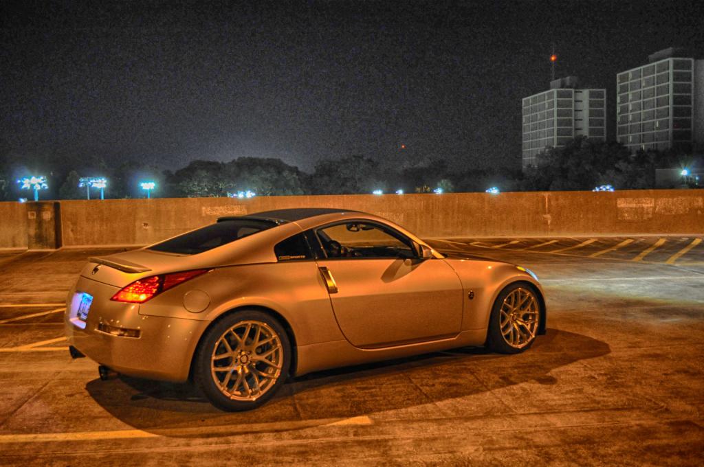

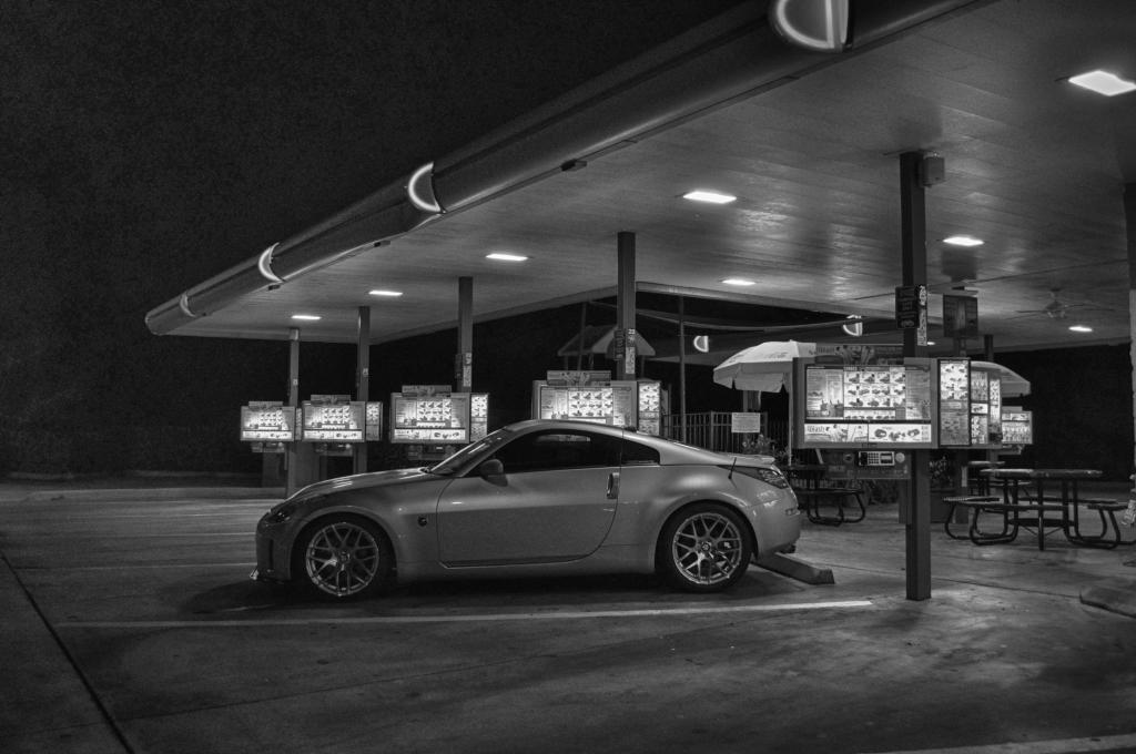

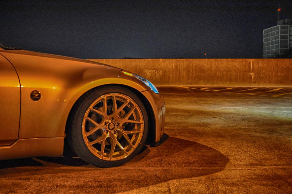

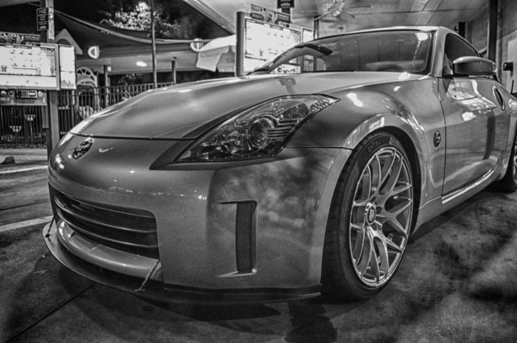

My new wheels: Ultimate Performance 720.
19x9.5 ET25 Sqaure.
Ohtsu FP8000 255/35/19 Front 285/35/19 Rear
