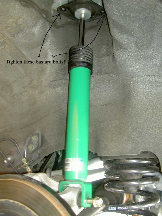

Did you try tightening the two bolts that connect the struts/ shocks to the chasis?
I left one bolt a little loose one time while I was installing my coilovers. I took a roll around the block to test out the height of the car, and the shock was tapping against the chasis/ brace tower just like you described it.
Re-torque those bolts to 60+lbs. Look at pic. below...
( I dunno why I say this, since you've probably done it already but its a possible remedy for others who might experience a tapping noise.)
If you already tried that, then your best bet is to take it into the dealer and have them re-torque everything associated with the axle and rear-sus. geometry.
I remember reading about someone who had a similar problem and had their "axle flanges" re-torqued and it was resolved.
Good luck man, I totally feel ya... f*ck any clicking and clanging noises they drive me nuts too.
60ft/lb??? thats triple what the service manual states (20ft/lbs)
i tried to fix this once and for all this weekend but i failed. i basically took apart the springs and the coilover and inspected the wheel well inside out. i couldnt find the source of the tapping noise...
when i reinstalled everything again, i tightened those two bolts on top damn snug, and every other bolt to spec. damn!!!!!
i'm pretty certain this issue is caused by something other than the suspension install. it REALLY seems like it is coming from aroudn the strut bar.. like a loose weld or something.
[edit]: i forgot to mention, i put back the stock damper too just to check if it came from the coilover damper itself.... no luck

Yeah sorry about the 60 lb/ft torque, that is WAAAY too much.
You can tighten that much, but you'll definitely get by with alot less and some Loctite. On second thought, I don't recommend anyone to tighten that much, you risk breaking that little bolt.
20lbs just seemed a little too weak at the time.
