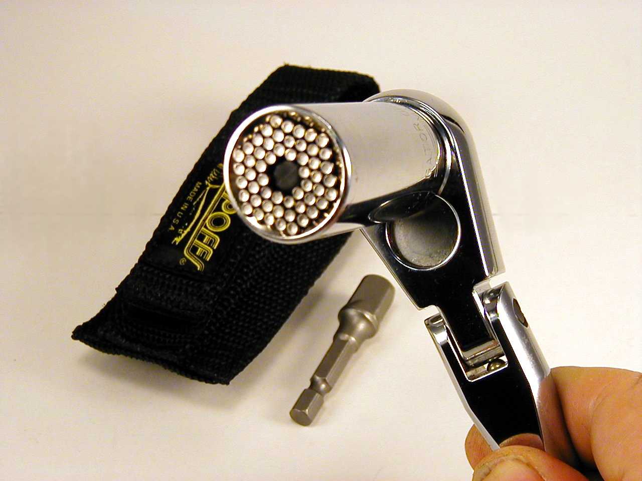

gator grip

I have lost my wheel lock key twice. The first time i ordered a replacement from the people that sold me the wheels. It was a number 47 key. I did not know the number I just took a picture of the lug and they ordered me the correct key. In most cases those gator grip things will not work. If you have to force remove, which I have, you can hammer a 19 mm socket onto the lug with an 8lb hammer. Takes numerous good hits to drive the socket on there. I have done this since the second time i lost my wheel lock key, I decided not to replace it and just get rid of the wheel locks. It only takes 10 minutes or so to remove 2 wheel locks by hammering the socket on.

Gator grip = POS. Put any kind of force on those, and goodby knuckles.
