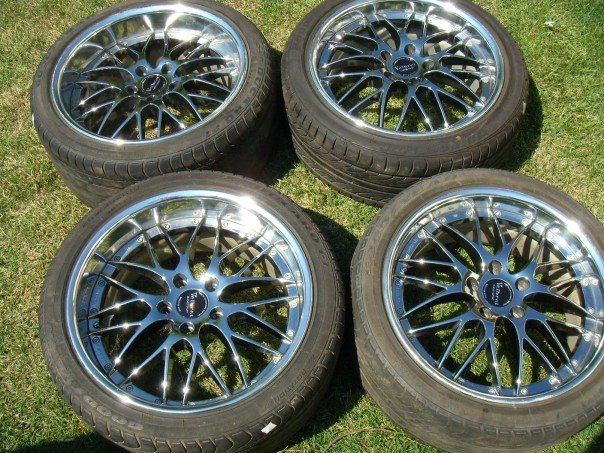

hey, i dont know much about wheels but i found a set i like and i want to know if they will fit or not, some one said the offset might not be right? so let me know thanks
Rears are 18x9.5 +43. Fronts are 18x8.5 +43. Bolt pattern is 5x114.3.

That offset is at least 2X what I would recommend.

you would need about a 30mm spacer, if not more, to bring this flush to the fenders

http://www.1010tires.com/WheelOffsetCalculator.asp
less offset, the more the wheels stick out. With a 9.5 rear you would need about a +0 to +15 to be flush with the fender.

technically you could get them to fit, but you don't want them.

I would get something with less offset. Those wheels will be so tucked in. Stock wheels are +30 so that will give you an idea of what they will look like. NOT GOOD!!! It's pointless to get them with the intention of using a HUGE spacer when you can just get wheels with the right offset.

Those are sedan fitments

a 25mm spacer would be needed to sit at a nice stance.
