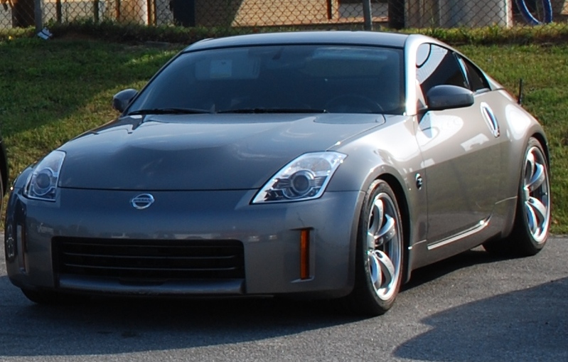

thats the setup i have on my car.
Well, 18 inch up front and 19 inch on rear (stock rays)

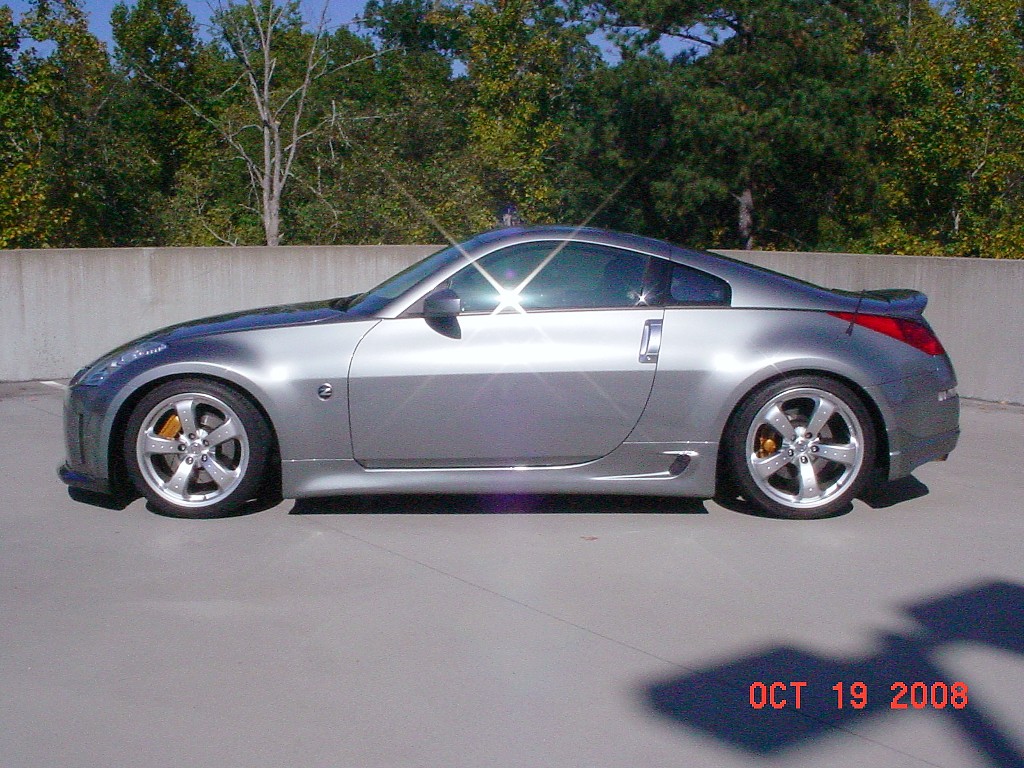

265/35/18 and 285/30/19.
Stock Rays 18x9 +30 and 19x10 +30.
Fits fine.
