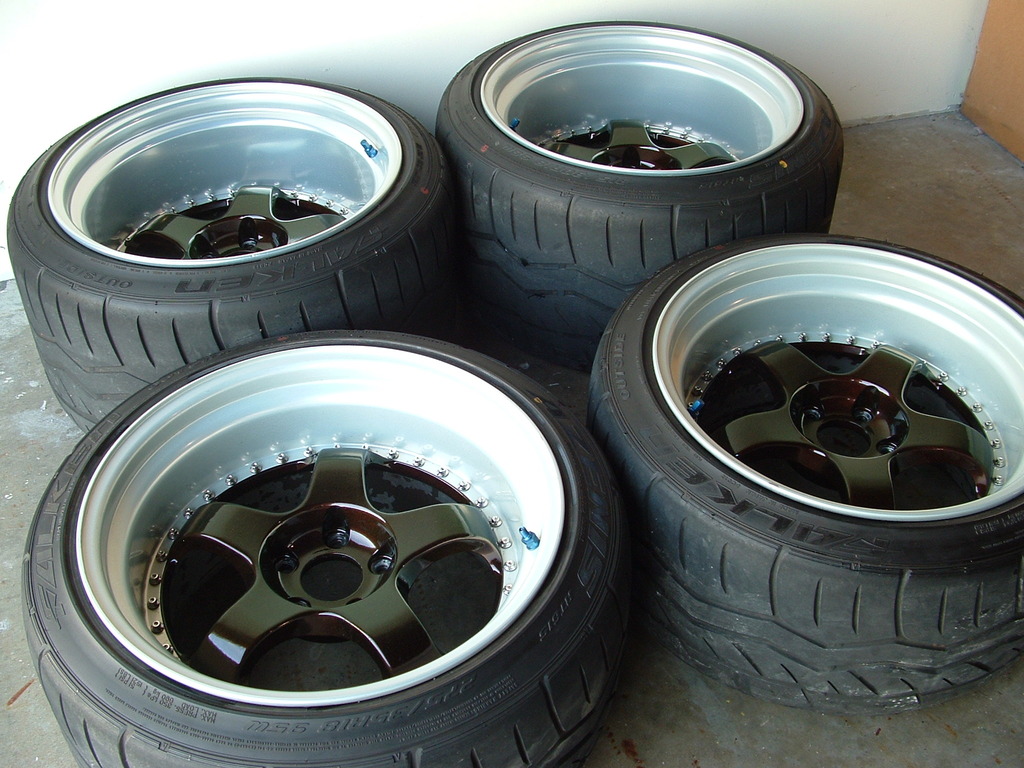

Another of mine. 18x10 +25 with 275/35-18 front, 18x11 +30 with 295/35-18 rear. Wheels are CCW C2K Corsair.

Looks good!

Nice wheels!

Dam, that is like freaking close to perfection. Awsome.

That means a lot to me coming from you sir. Perfection will be when I get new tires and run 295/30 and 315/30.
