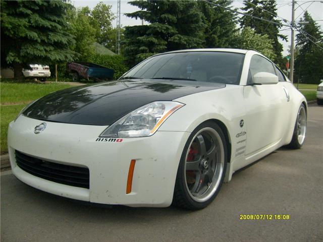

when i had crappy offset( basically same as yours) i used 20mm spacer f&b no rubing, but for awhile i had no spacers and here's a picture of what it looked like (front 19x8 30mm rear 19x10 30mm), but my opinion with the extra money you'll spend on spacers, get some better offset wheels
or do what terrasmak said
