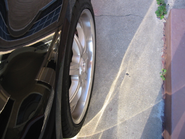

i had mine special made for my bigbrake kit.you want to have hub centric ones & w/studs..so important to have hubs on there as well.they call it adaptors w/hubs..the place is called rusell here in torrance,kali.went to the machine shop where they make it.big azz shop.they took my wheels down for measurement.they are very professional.it only took them 2 days to make all 4..amazing.they are light too.here's some pics.

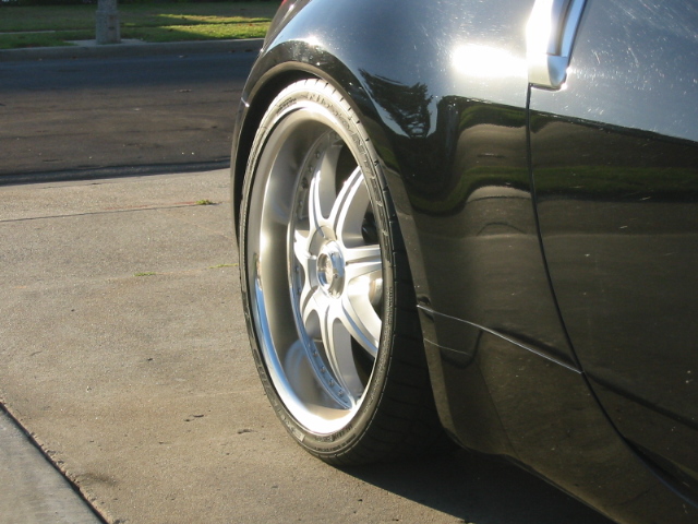

From: Long Biatch
this 1st 2 pics are front.thicker than rear.

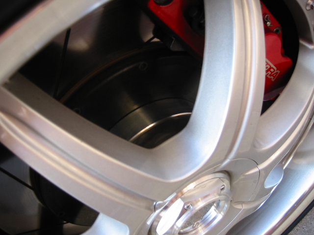

Posts: 202
From: Long Biatch
Rear,notice they stick out more.doesn't rub @ all.
