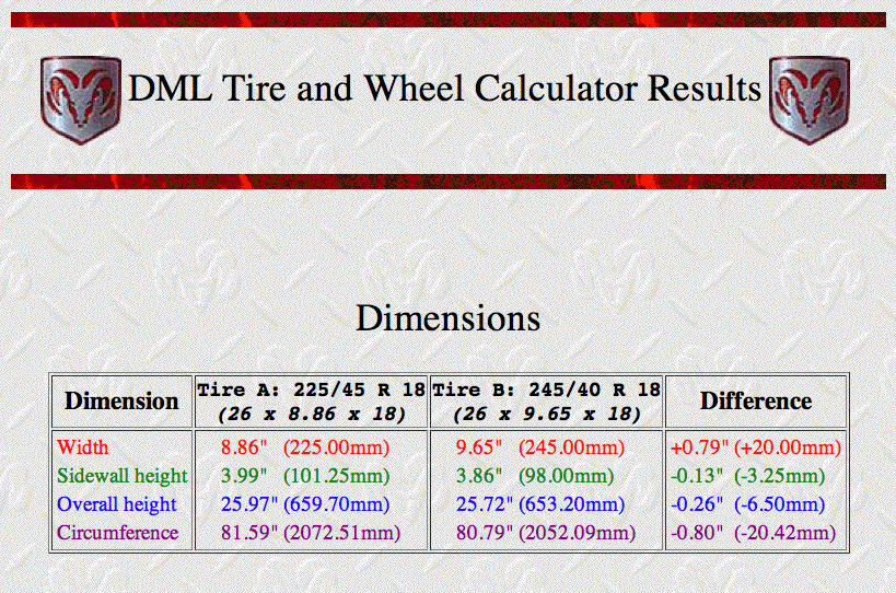

Hi all, I know this post might have been asked before, I tried searching but couldn't come close. Well, I have OEM 06 18" rim and took it for a tyre change this afternoon. The dealer gave me 18/45/225 front and 18/40/245 rear with Bridgestone RE001 as he doesnt have 45 for the rear.
I know the original sizing is 45 for both front and rear. My question is, will the new difference cause any problems to my car? I'm worried it'll do damage to my car. Please advice.

It might cause problems for you if your Z has TCS or VDC. The front tires are now taller than the rears, on a TCS/VDC equipped Z, the rears are taller than the fronts. You may see intermittent problems with the SLIP/VDC OFF lights coming on because the computer is not seeing the proper relative rotations of the front to rear wheels.

As DavesZ#3 mentioned front tires are taller than rear. Confuses VDC all to hell.

but if you have to you could run 18/40/225 up front to balance it out with the 40 series in the rear

Move the 245/40-18" from the rear to the front, and replace the rears with 245/45-18" tires.

If he's correct that they are RE-01's then he's really screwed since Bridgestone stopped making them about 2 years ago. RE-11s would be the proper replacement.
The RE-11s are and the RE-01s were available in both 40 and 45 profiles for both the 225/18 and 245/18 sizes. My guess is the dealer didn't have them in stock and didn't want to wait for an order to arrive.
