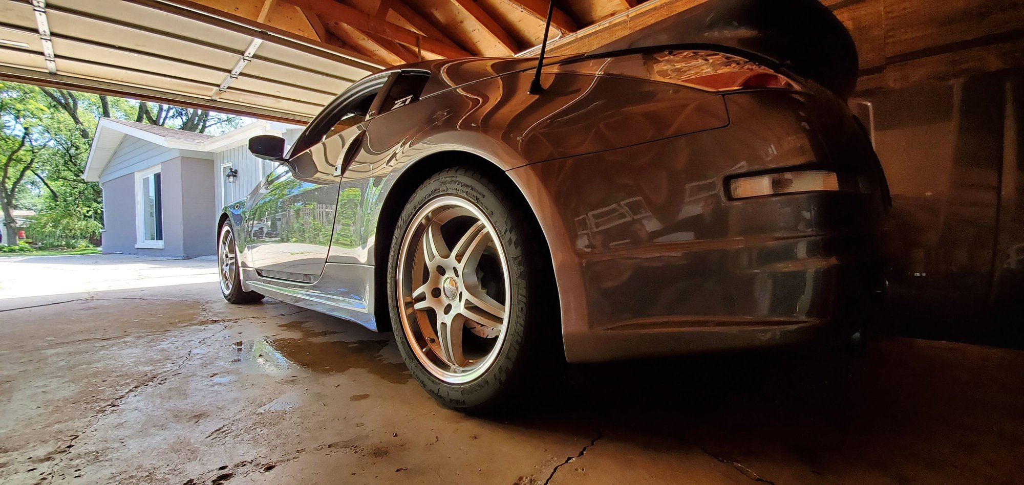

Hi, so I've been researching and looking at pictures until I got tired of doing so. I need assistance figuring out the last details for wheel widths and offsets, looking to get 275/30/19 F and 305/30/19 R for tire sizes. From what I gathered from research a popular width would be 9.5 F and 11 R for those tire sizes but I have no idea about offsets. I'm on S-tune springs and have camber arms front and back, rolled all around as well. Looking to be flush to slightly tucked, no poke if possible.
Any help is appreciated, here is a picture of how the car is currently sitting.

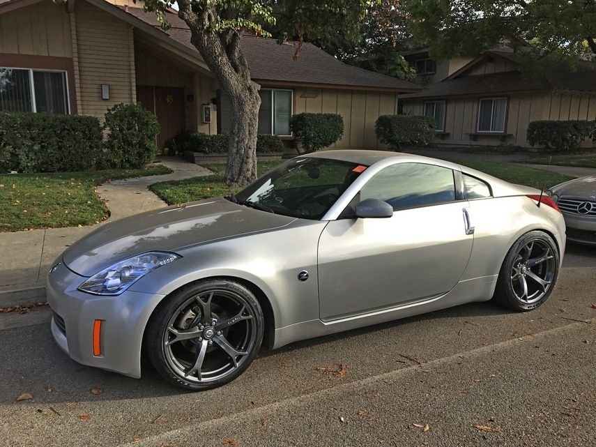

But will just say off top of head that a front offset on 9.5 wheels of between +17 and +25 will pretty much get you where you need to be AND a rear offset of +22 to+25 on 11" wheels will put you right at the fender lip. If you insist on 11s, go with +25.

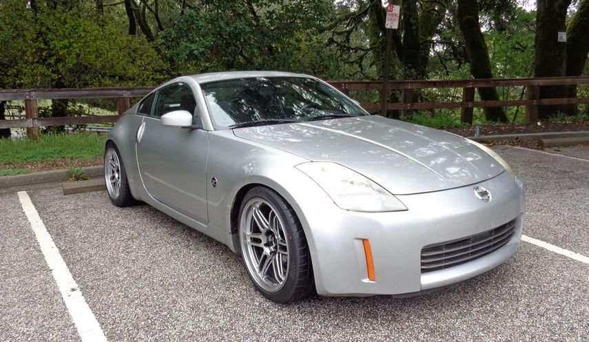

My usual visual aids 9.5 +22 and 10.5 +22 (static suspension at -19mm and alignment is stock (lowest end of camber range). Keep in mind that I'm "only" running 255/35 & 285/35-19 so tire clearance might be more of an issue running the sizes you want to run.
Rears (above, below)
Front

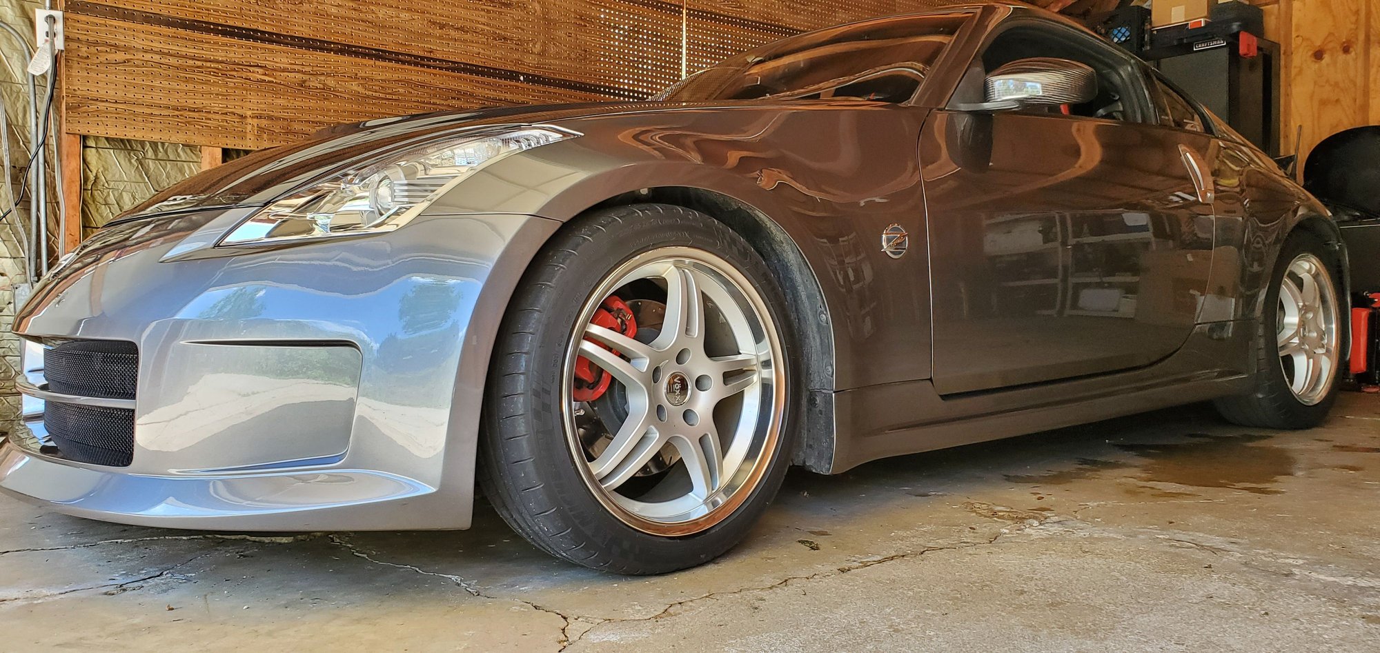

Or my current setup... Nissan LMGT5 19x9.5 +20 effective & 19x10.5 +23 natural
