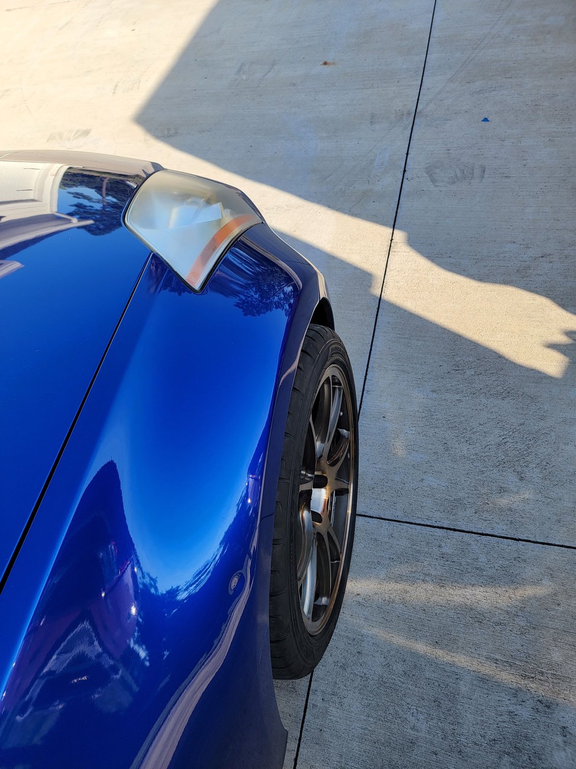

Looks good. Now to get the 275 Kenda

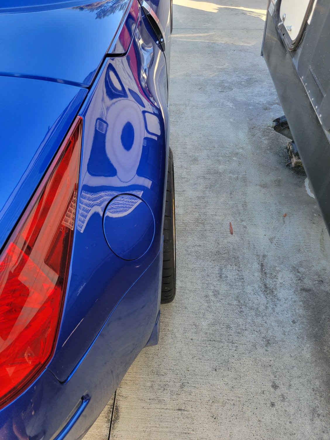

The OO of the wheels had them on his 370Z - he used spacers for the rear. He gave them to me. If you look at the pics I posted, it pushed the rears to where they are just about flush.

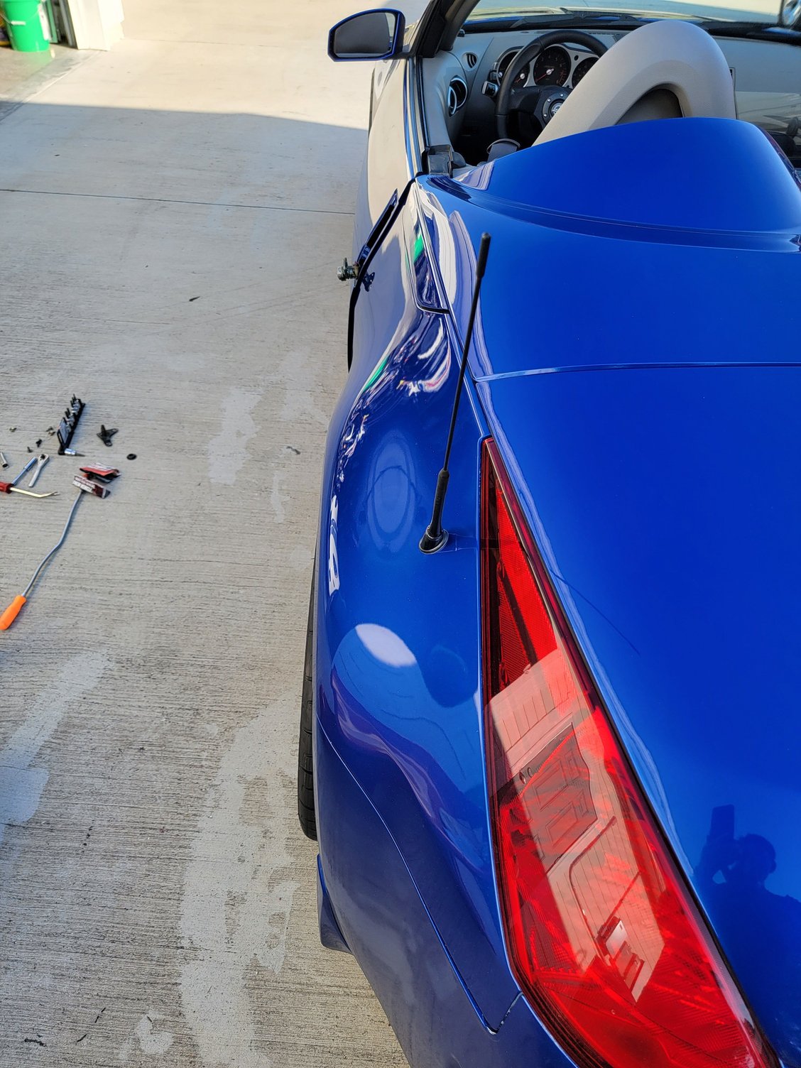

The tires did NOT CLEAR the uprights. Had to use a 25mm spacer.
Ended up using 30mm in the rear to make it look even.

DS - you can see that I am replacing the door handle.

And the rear is rubbing slightly on the outside when I hit a bump. Going to switch out the 30mm spacers to 25mm spacers tonight.

Swapped out the spacers, now no rubbing - it was only doing it on one bridge on my drive to work due to the undulations caused by the expansion joints on the bridge. Drove it the last two days and no ill effects.
And the door handle is replaced, no more ghetto style opening the car from the pax side.
