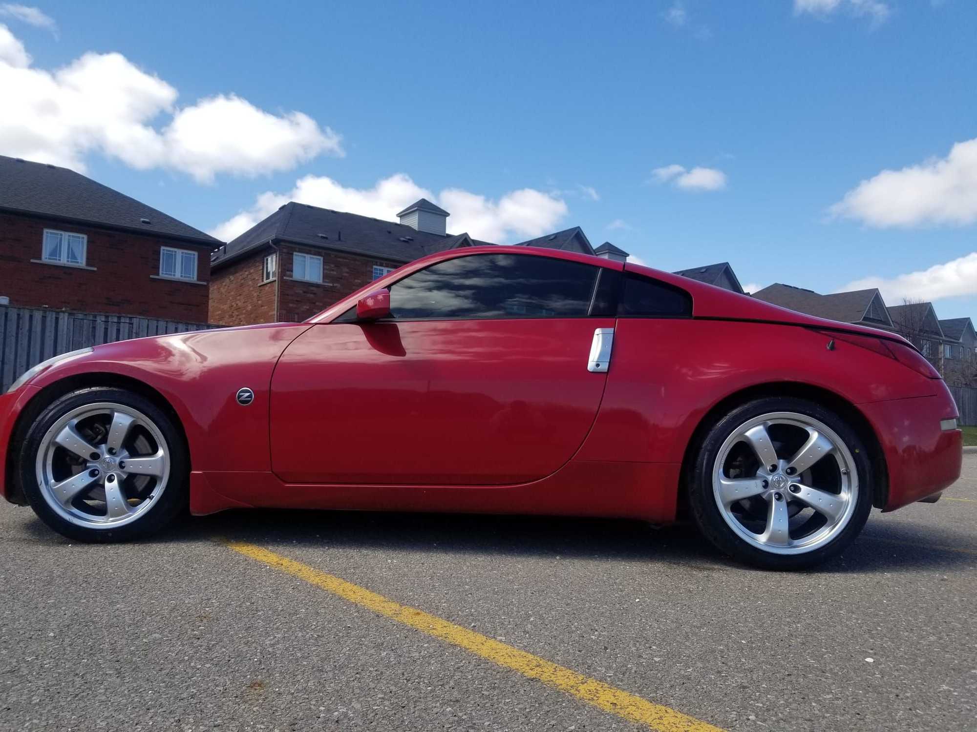

These are the stock rims from 350z Grand Touring. 18" front and 19" rear. Love this staggered setup. Rear tires are 275/35/19 and fronts are 245/40/18. 19" rear makes a big difference looks wise.
