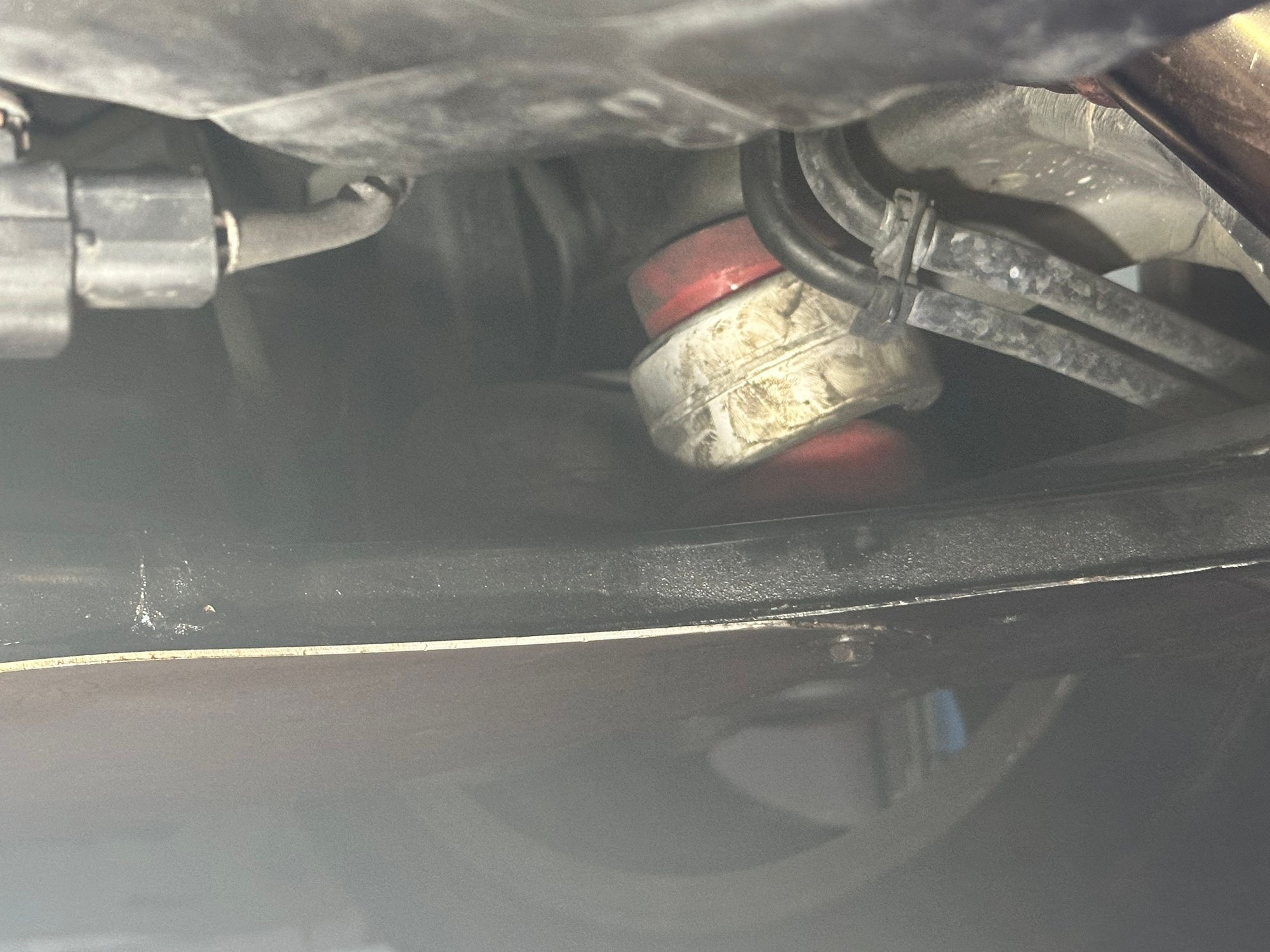

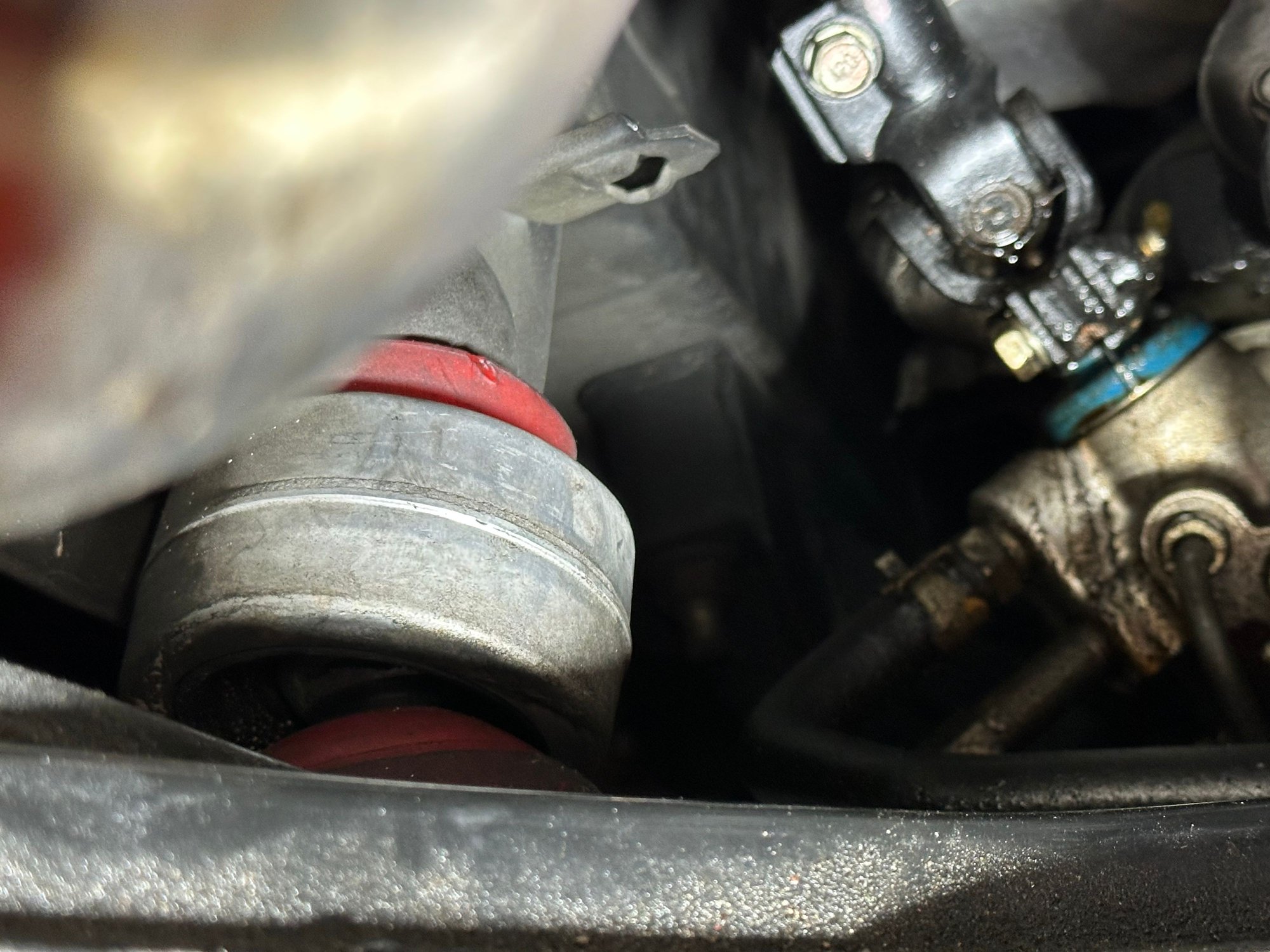

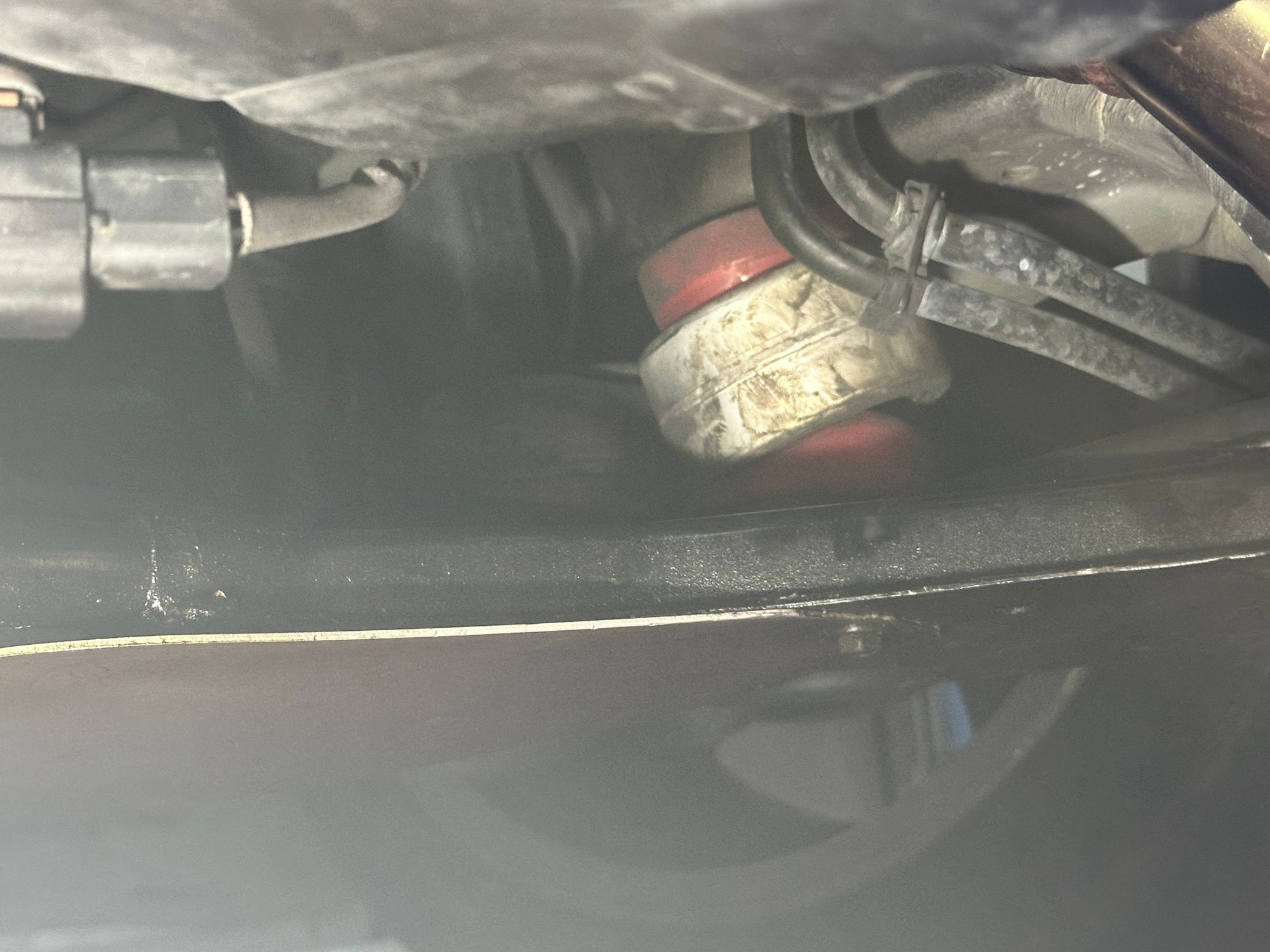

Default car is on z1 tubular fucas / BC Racing Coilovers but look
the front rear control bushings look off. see the red, how do other cars like mine with similar setups look?
but this is with the 350z hr on a jack stand from rear.

THE only bushing you should have there is Whiteline, preferably SPL tho. ES is not a good bushing in that location.

In that Compression Arm or Radius Arm, I have White line bushings. I think with ES is that they are oversized bushings and haven’t heard the best things about them. It looks off, but does it drive off?

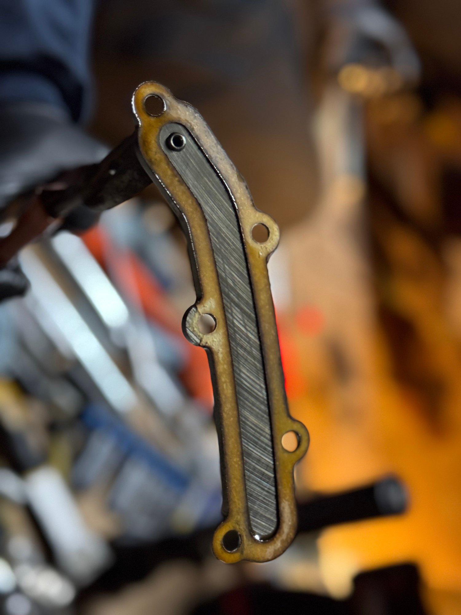

Meanwhile… I took it upon myself to replace the water pump on my 195K mile engine. Took ages to get to this point. Already replaced the thermostat, and water pump, and the lower gallery gasket and the timing is set at top dead center with marking noted for insurance but I need help.
The upper left Philip screw is behind the cam shaft, and I can’t get to it even with rotating the cam shaft. It’s the last one and it’s starting to unfortunately nearly round out.
Any suggestions? What did you guys do when you did your gallery gasket job? Take off the cam shaft? How so?
Bottom gallery gasket at 195K miles.

For the philips screw, I recommend one of those impact drivers. I bought one for brake rotors after getting super frustrated with those countersunk philips screws stripping out. Impact drivers also work wonders for odd jobs like this. I think that's your best option at this point since it's already started to strip out. If you started fresh, I would've used a light duty cordless impact with the correct philips bit (looks like #2, but could be some Japanese spec which are slightly different). Worst case scenario, you may need to drill it out, but I think you have a solid chance of cracking it with an impact driver.

give it a good smack with a hammer. Sometimes that will help but I agree with Icer. Best bet now would be to use and impact driver with the correct bit.
Question though. After breaking it loose how would that screw come out if that sprocket is in the way? At least from the picture it seems like

@bre240z Fluctuating coolant temperatures, and leaks from the weep hole. It came as droplets and moved to puddle overnight with visible coolant leak.
Main thing was the water pump, upon removal, it had damaged o-ring.
Figured I’d do gallery gaskets as well. Albeit some trouble on the top gasket. Haven’t worked on it since due to work schedule til Friday morning.
@icer5160 Copy; I’ll send it with the impact driver. I’ll try to hammer in the drive bits and try to remove it with an impact driver applying inward pressure on Friday.
Do you have room enough to use an impact screwdriver? Like this ?
Also, I would try and lightly impact it tighter, first (to try and help break the threads free) and then go for the loosen.

It's going to be tight with the cam gear in place. But I think it can be done, most impact driver sets have long bits (about 2-3inch), which might just give enough length to clear the cam gear. If the gear creates to much interference (hard to tell with the photo angle, parallax might be playing a part), meaning he can't get the bit straight on, then the only option is to remove the main timing chain and and pull the gear. I think that would take less effort/time vs. stripping it out and moving to drill it out.
