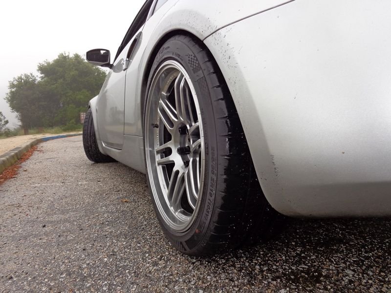

Since I'm a "visual person", here's those exact sizes on my car with 9.5 +19/10.5 +29:

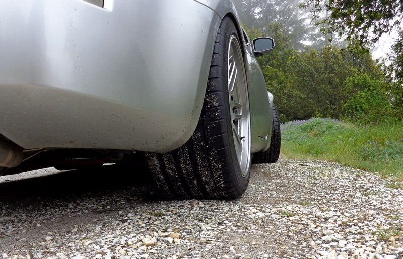

Same size wheels, F&R +22mm with 255/35 and 285/35 (but note that my fenders ARE rolled for clearance for my +15s so just about anything fits now):
Good luck! Post pics when done!
