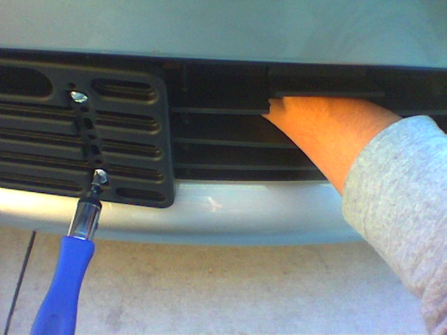

instead of placing the toggle bolts through the tow hook, i placed them on the right side of the grille,since the intake was on the left side, not that it would affect it that much.
materials:
4 toggle bolts
1 universal license plate holder
1 screwdriver
optional:
clear license plate cover (for freeway rocks,debris, etc.)
Attached Thumbnails Front license plate toggle bolt method-philippines-048.jpg

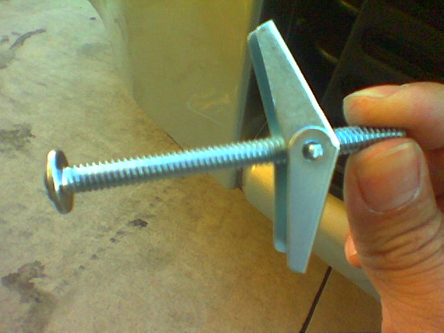

Old Feb 8, 2004 | 01:20 PM
victory1's Avatar
victory1
Posts: 164
From: LA, CA
Default still don't know how to post multiple pics
toggle bolts
Attached Thumbnails Front license plate toggle bolt method-philippines-044.jpg
Old Feb 8, 2004 | 01:23 PM
victory1's Avatar
victory1
Posts: 164
From: LA, CA
Default installing was easy
just place it in the grille. do it tight.
Attached Thumbnails Front license plate toggle bolt method-philippines-045.jpg

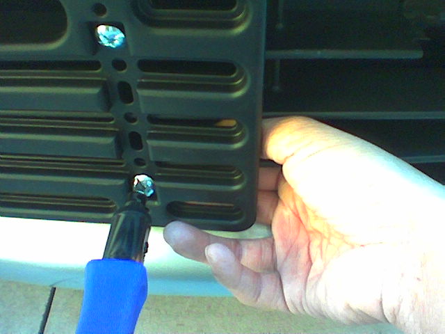

Old Feb 8, 2004 | 01:33 PM
victory1's Avatar
victory1
Posts: 164
From: LA, CA
Default bracket install done
just mount the plate, and the optional clear plate cover
by the way, the Cali fix-it ticket cost $25. plus $10 inspection fee at the sheriff's office. (i heard you can avoid paying the $10 if you go somewhere else that doesn't charge the fee.)
Attached Thumbnails Front license plate toggle bolt method-philippines-046.jpg

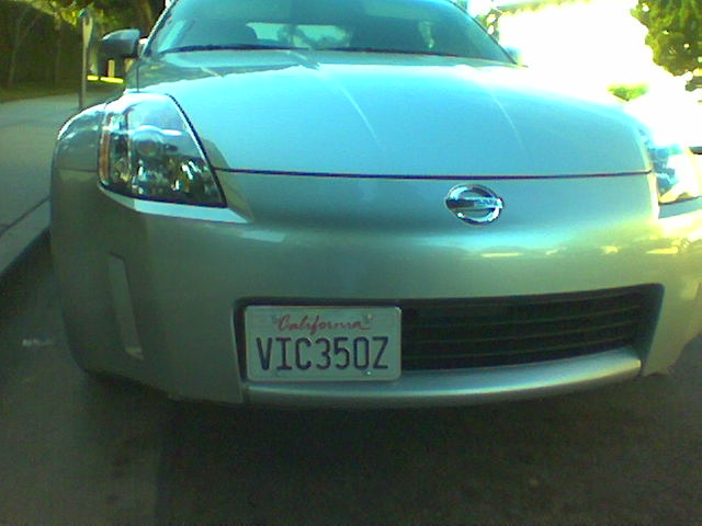

Old Feb 8, 2004 | 01:38 PM
victory1's Avatar
victory1
Posts: 164
From: LA, CA
Default pic of installed lic. plate
better than having to drill the holes on the bumper, i'd say.
total cost: $12
hope this helps, everyone
vic
Attached Thumbnails Front license plate toggle bolt method-philippines-049.jpg
Old Feb 8, 2004 | 05:36 PM
yobri's Avatar
yobri
Joined: Jun 2001
Posts: 17,685
From: teh interwebnets
Cool victory! Still I'd prefer a center mount (I guess for aesthetical balance purposes), but it sure beats any other [expensive] monetary investment.

Default maybe so
but it was way easier to install it on the side esp. with big hands... i could put my whole hand/arm inside the grille through the center part that opens up (pic #3)
maybe take a little more time to do center, but i'm a procrastinator and did it on the last day (inpection)
thanx for the feedback yo
vic
