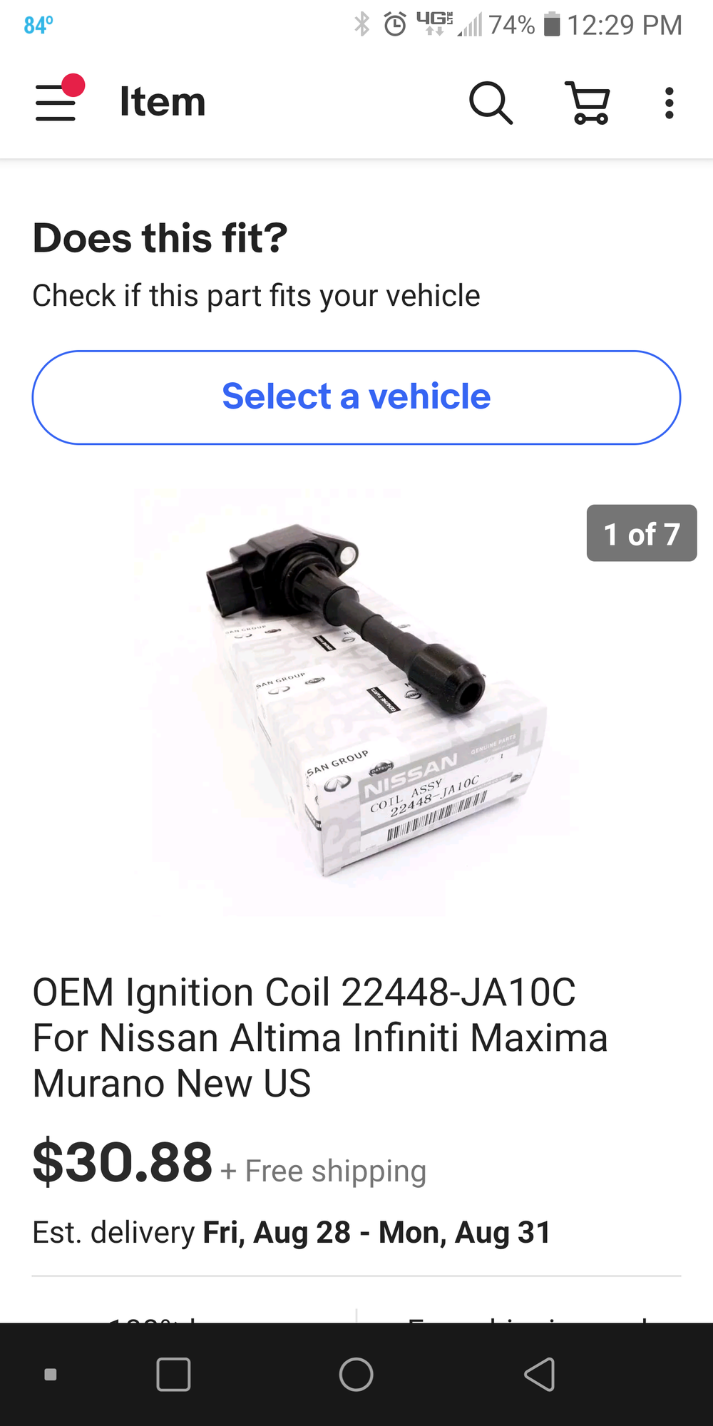

What do you guys know about brands for coils? I see these "genuine Nissan" boxed stamped with "Hanshin" as the maker. However, I discovered other, what seems to be REAL, OEM coils in a seperate box. See the screen shots below.
​​​​​​My other option is getting Hitachi ones which I am pretty sure are the OE manufacturer. I can get those off rockauto.
Thoughts?
