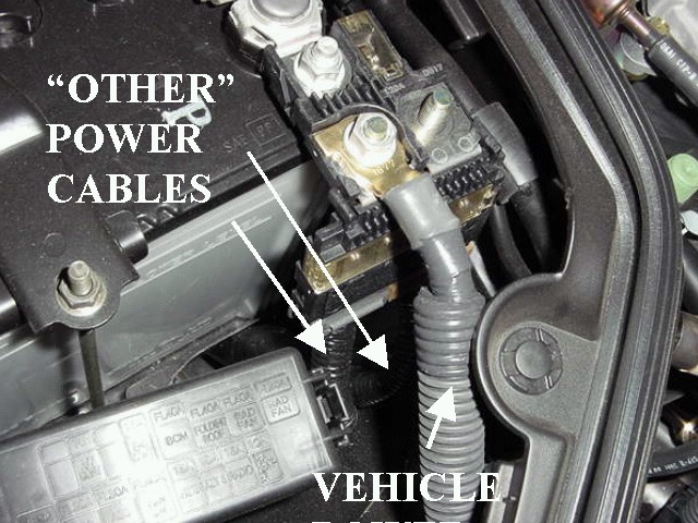

Sorry guys, I'm not making myself clear. There is ALREADY a power cable there from my Blose system (I think), see pic. Has anyone tried to use this power cable to power a different amp?
thanks
thanks
Would not suggest using any of the stock cables or connecting it to any of those points. Stock cable size might be too small for aftermarket amps. Also those points are Fused and might blow with aftermarket amps.
