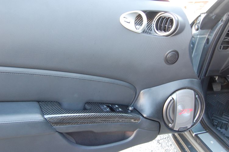

first off, get he wicked C.A.S. door pods...you will thank me for this. it truly does bring out the sound, not to mention you dont have to worry about the bass rattling the inside of the door panel.
They make amps that can power your front stage and a sub. this would be ok for you since it sounds like you're just wanting to run one sub for that little extra kick.
I'm running the new Alpine type r components, although I had the tweeter relocated in the door, cause the factory location sucks just like the 6 1/2" does. I'm really happy with the sound I get out of these. I would only switch to something else if I had a lot more money, but since I wanted to stay under $250, I went with these.

If you buy pods from Wicked CAS, you would need to install them which involves screwing it to the door panel. If you go with kick panels, they would be a direct replacement for the OE panels. Bing (16psibrick) can probably offer you a package deal on components and kicks. You are in so cal, so maybe you could drive to his shop or conduct the transaction though UPS (or whatever).
If you want to leave the stock look, you will want to use a 1" spacer made of MDF (make your own, buy from Zenclosures, or make from OEM speaker). Then you will want to modify the OE speaker grill using 1 of the 2 methods that you could find here or in the DIY section. Then the tweeter you could install in the kick panel - this could be done easily DIY, no major modding needed. This will definitely be light years better than the OE setup.
