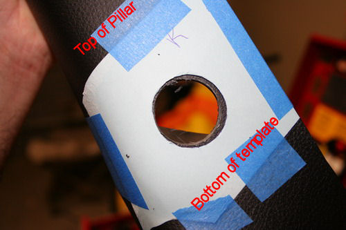

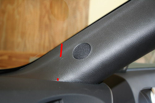

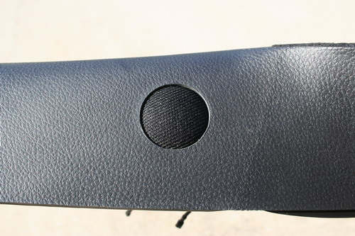

Here is what I did. I am real happy with it.
Attached Thumbnails Anyone make tweeter pods for the a-pillar?-1.jpg   Anyone make tweeter pods for the a-pillar?-2.jpg   Anyone make tweeter pods for the a-pillar?-3.jpg   Anyone make tweeter pods for the a-pillar?-4.jpg   Anyone make tweeter pods for the a-pillar?-5.jpg

Very clean install! Did you do any comparisons with pointing the tweeter in any other directions?

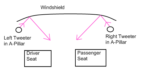

Your goal is delivering sound to the center of your car’s interior. This is easy with a SubW, a little more difficult with a midrange, and most difficult with tweeters.
Tweeters are the most difficult because the high frequency sound is very directional. If you direct the tweeters “straight across” (i.e., putting the tweeters in the sail panel), it’s very challenging to balance the sound for both the driver and passenger. That’s simple because the right tweeter is so close to the passenger and the left tweeter is so close to the driver. The solution in this case is balance the tweeters for either (driver or passenger), but you cannot do this for both.
A better solution is what cdoxp800 does, and describes in his thread: https://my350z.com/forum/audio-and-v...placement.html
cdoxp800’s thread is just great because it describes the concept fully, and his thread is also a DIY. Most members here do not go to this extent (conceptual details along with specific installation instructions that include pictures).
Here is an example of staging the tweeter’s sound.
A successful installation depends upon bouncing the directional sound from your A-Pillar mounted tweeters towards the center of the car. If you get it right, the sound is great. The driver and passenger hear left and right, but neither channel is overwhelming.
Spike
