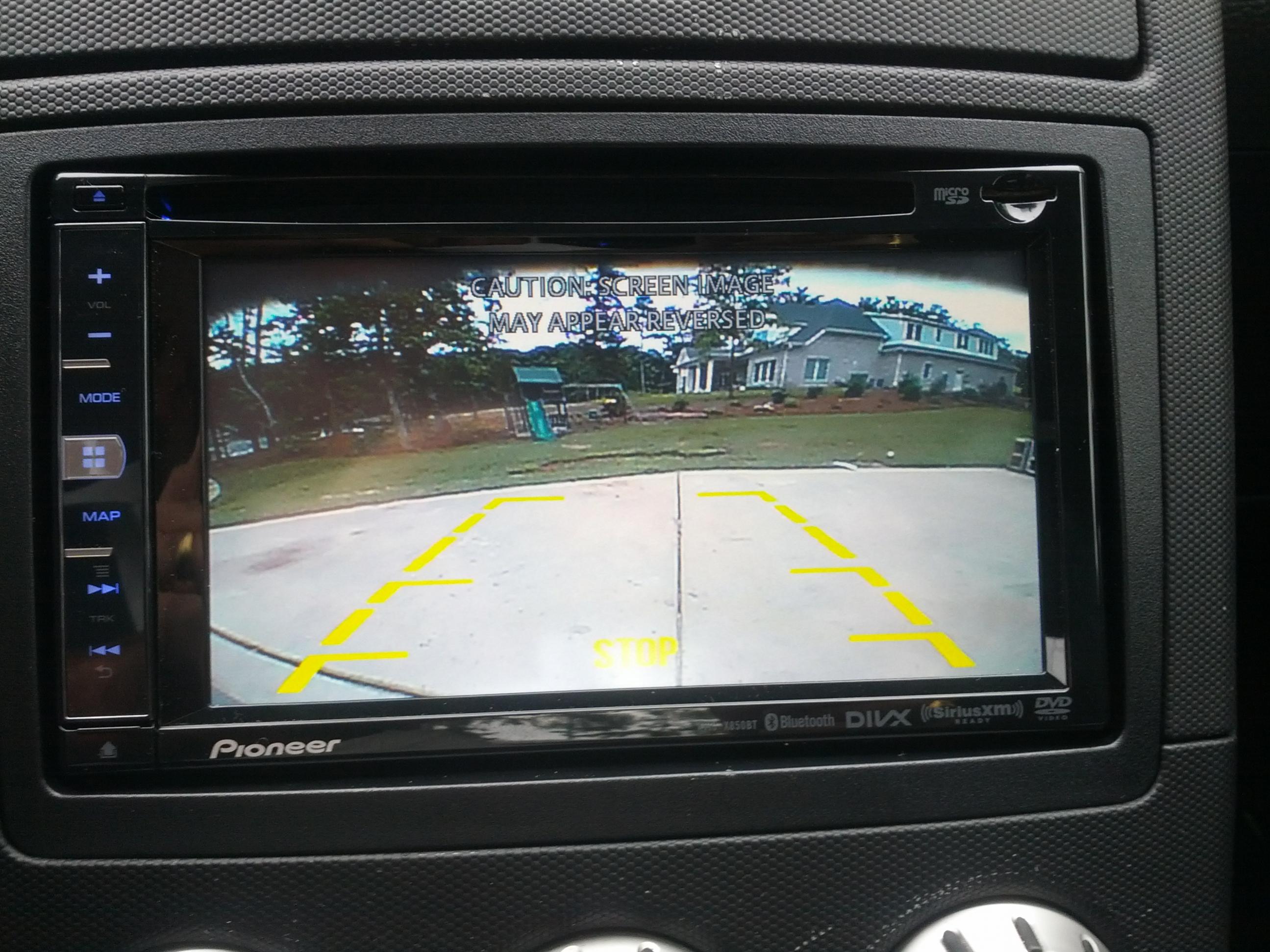

Here's the link to the one I got:
CCD Camera
Looks like there are still more than 10 available. Take about 2+ weeks to ship from Hong Kong. Also - Here is a picture of how clear the image is. I was pretty impressed for $20.

Micro SD slot up front is a nice touch!!
I like how recessed your radio is. Mine sticks out (DDX 470), not a lot but its not as flush as yours.
